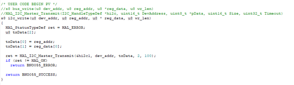

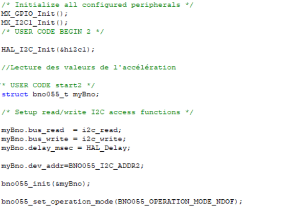

I'm trying to connect a bosch sensor BNO055 (adafruit) by I2C to my Stm32L072CZ6YTR. I'm new with the environnement of STM32 so i try to program the ship with basic tutorial about STM32 I2C connection. I have write the functions who permit to read and write on the i2C bus but i have no respond of my ship when the program call this functions.
For helping you, to understant where is my problem, i copy the code that i have write to initialize the sensor ( i just follow the structure include in the Bosch Sensortech Datasheet).
The problem come from the fonction write and read because my BNO055 is properly connected to my STM32. If someone have experience with BNO055 please help me to resolve my problem.

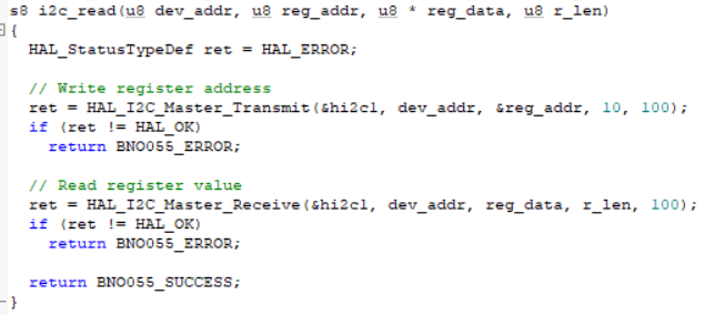

The function for that I used to read or write are here :

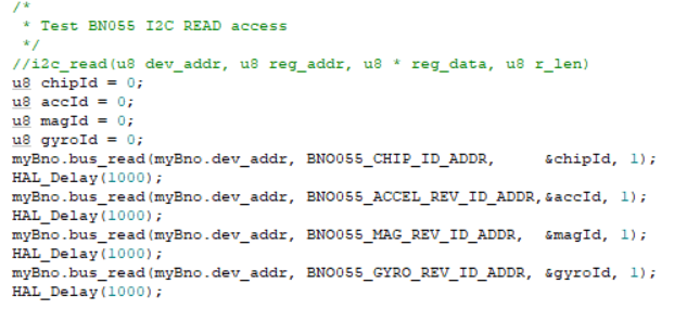

The code that i use to test the i2c connection ( I simply try to read register with constant value):
If someone on this forum can explain to me where is my error, that can be very useful for me. Thank you.

Pretty sure the reg_data isn't 10 bytes wide.
Talking to an OLED attached to the Murata module using the Mem functions.
HAL_I2C_Mem_Read(&I2CHandle, Addr, Reg, I2C_MEMADD_SIZE_8BIT, &Value, 1, 1000);

OK, thanks for your answer. I think that i have no connection between my sensor and my STM32...
I receive no acknowledge of the sensor and my process of initialisation always end with an HAL_ERROR. I juste initialise I2C1 in standard mode with CubeMX and put the clock to the good frequency for the sensor.
Have you and idea of the error of initialisation of my code with CubeMx i do that prevent the connection between the sensor and the STM32 ?

The address should be 0x50 (0x28 << 1) for the BOSCH part.
mibou23
The initialization was ok. The error came from the adress of the peripherique. I directly used the "#define BNO055_I2C_ADDR1 " who was write on the Bosch Datasheet.
I'm really grathefull for your help. The communication seems working now.
Can you explain me why we can't use the define give by the manufacturer and we need to shift to obtain the good adress ?
Because the slave address is 7 bit while most people see I2C physical bit transaction to be 8+1 (8 bits one direction, 1 on the other).
EEPROM typically would be address 0x50 but in practice, most people say 0xA0/A1 (write and read included).

it is a 7-bit address, it is left (high order) aligned on the bus, the low order bit indicating read/write. The ST HW doesn't shift, so you need to be detail orientated, different micro-controllers implement this in a number of ways, all valid, and documented.
