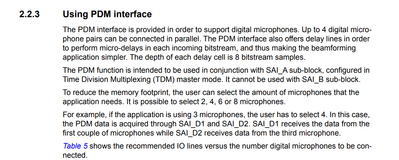

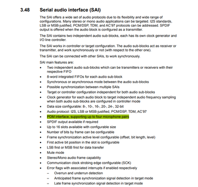

@ELABI.1 wrote:
you can connect up to 8 PDM microphones by using the SAI peripheral's PDM interface.
UPDATE: That post has since been edited.
@KDJEM.1 wrote:
It isn't possible to connect 8 PDM microphones by using the SAI.
So which is it, then ?
KDJEM.1
Hello @Andrew Neil ;
We noted a typo in datasheet and reference manual, the STM32N6 supports actually 6 microphones.
This issue is reported internally.
Internal ticket number CDM0061647(This is an internal tracking number and is not accessible or usable by customers).
I apologize for any inconvenience.
Thank you.
Kaouthar
Ah, I see that @ELABI.1 has now edited the post to remove the references to the erroneous sections in the Datasheet (DS14791 Rev 9) and AN5027 (Rev 2), and the conclusion that 8 was possible.
PS:
It seems that RM0486 (Rev 3) also has the typo.
