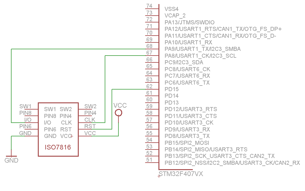

Hi, everybody. My task is to connect STM32F4 discovery Board with Smart Card ISO7816. I don't use interface ST8024CDR only hooked paid directly by the scheme specified in the image:0690X000008ANWeQAO.png
I tried to adapt the Cubex project to STM32F1xx-EVAL. ATR reception does not work. The oscilloscope shows that the I/O port from the map is something similar to a sawtooth signal, but more flat (on three different maps it is different). So I guess it's still an ATR.
The configuration of the UART and frequency:

Trying to read directly:
HAL_GPIO_WritePin(GPIOD, GPIO_PIN_15, GPIO_PIN_RESET);
HAL_Delay(500);
HAL_GPIO_WritePin(GPIOD, GPIO_PIN_15, GPIO_PIN_SET);
convention=HAL_SMARTCARD_Receive(&SmartCardHandle, atr_buff, atr_size, 500);
HAL_Delay(12);
/* Insert delay of 20ms for signal stabilization */
HAL_Delay(300);
PD15 - Reset.
I always get zeros. What could be the problem?

If anyone is interested, the problem is solved very simply. I used USART3 instead of USART1 and everything was considered successful.
