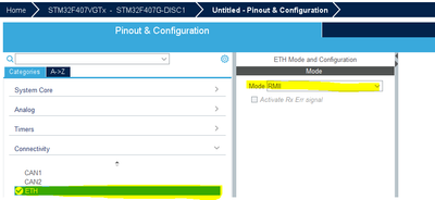

I'm working with an STM32F407DISC and an LTE modem connected via USART. I want to configure PPP communication using LWIP. Could you explain how to set up PPP in this context(ioc file)?
Additionally, is it possible to enable the Ethernet (ETH) interface without using its physical pins, just for PPP over serial?

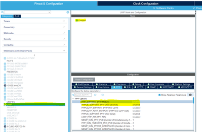

Hello @Noushadalik ,
I confirm that the steps shared in this post are developed to set PPP for STM32H747 MCU but you get inspired from these steps to set PPP for STM32F407. The DCache is not available in STM32F407.
To set PPP in STM32F407G-DISC1:
-1- Configure the ethernet as shown in the below figure ( RMII mode for example)
2- Enable LWIP
- Use PPP_SUPPORT requires PPPOS_SUPPORT, PPPOE_SUPPORT or PPPOL2TP_SUPPORT turned on.
- PPP_SUPPORT needs also PPP_IPV4_SUPPORT and/or PPP_IPV6_SUPPORT turned on.
Currently STM32CubeMx do not give possibility to select LwIp Middleware without to have previously selected Ethernet. So, you can enable LWIP only if ETH IP is configured.
Thank you.
