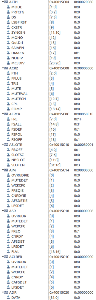

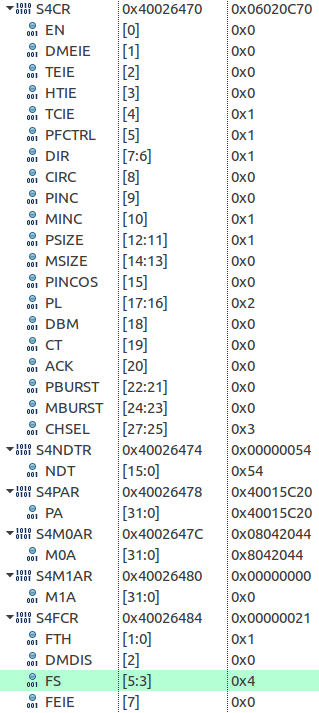

As soon as I enable the DMA channel FEIF4 (FIFO overrun/underrun) flag becomes active. After enabling the SAI2 interface and waiting few clock cycles TEIF4 (Transfer error) flag becomes active and disables the DMA channel. I've attached SAI2 A and DMA2 stream 4 register values below. I have no experience with DMA or SAI so maybe there's something wrong with the registers. If the registers seem OK could this be clock issue? Any help would be greatly appreciated. Please ask more info if you need to.

Don't set PFCTRL in DMAStream_CR - read 9.3.16 Flow controller.
In direct mode, you should ignore the FEIF - there's an explanation somewhere in the forum why this happens but now the forum is in havoc and I'm not going to look it up.
You may want to set the FIFO threshold somewhat higher than empty, otherwise the FIFO is effectively unused.
Your SLOTR appears to be inconsistent: you set (by SLOTSZ =0) slot size equal to data size, yet try to shift the slot by FBOFF (it's ineffective but should be 0 nonetheless - the characteristic I2S 1-bit shift is already accomplished by setting FRCR.FSOFF=1); you set only one slot per frame in NBSLOT yet enable two in the SLOTEN bitmask. This btw violates the requirement for 'The number of slots should be even if FSDEF bit in the SAI_xFRCR register is set.'
PS. What debugger is this? SAI_CR1.MCKDIV is misspelled as MCJDIV... :)

Thanks! I got DMA working with your instructions. Now I have to study how slots work.
