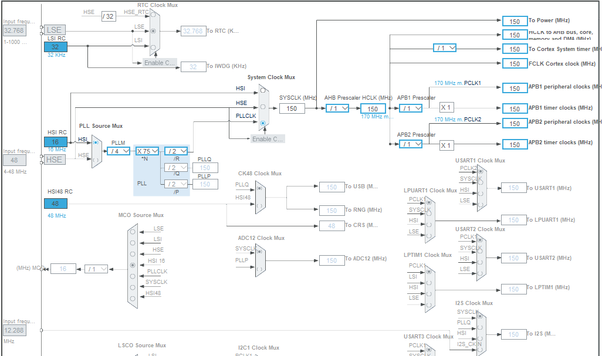

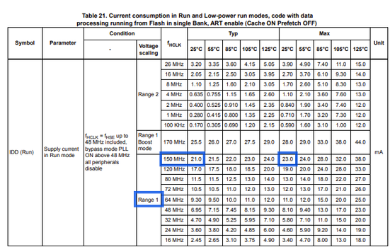

I have the NUCLEO-G431RB, and I am trying to measure the MCU current consumption in different operation modes and frequencies. I have connected a multimeter at JP6 (IDD) to monitor the current. The problem is when I set the frequency (f HCLK) as stated in the datasheet the readings I got are very different from the one in the datasheet. You can see in Figure 1 an example of what I did in configuring the clock trying to get similar values as in the datasheet in Figure 2.
Figure 1
the current value I got is 29mA.
I want to know exactly how I should configure the clock in a proper way to get the correct readings

Are you sure all peripherals are disabled, prefetch is of, cashe is of, debug is disactivated.... Also, you need to make sure that temperture is exactly 25°.

I did not activate any peripherals, also 'Cashe' ON and 'Prefetch' OFF as the datasheet states. I did set them both OFF and no changes happened.
Could you show me in detail how can I set the MCU settings correctly?
It is probably that I missed something that led to the wrong setup.
