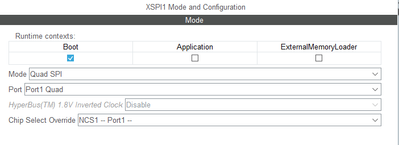

For example if you configure the XSPI1 mode Quad SPI (no multiplexed mode), then generate the code.
 You can see the XSPIM configuration in the generated code
  sXspiManagerCfg.nCSOverride = HAL_XSPI_CSSEL_OVR_NCS1;
  sXspiManagerCfg.IOPort = HAL_XSPIM_IOPORT_1;
  if (HAL_XSPIM_Config(&hxspi1, &sXspiManagerCfg, HAL_XSPI_TIMEOUT_DEFAULT_VALUE) != HAL_OK)
    Error_Handler();
But, if you asked about XSPIM peripheral clock, you need to set XSPIM clock when using the XSPI interface.
    __HAL_RCC_XSPIM_CLK_ENABLE();
    __HAL_RCC_XSPI1_CLK_ENABLE();

The XSPI is the Extended-SPI interface and the XSPIM is XSPI I/O manager.
The STM32H7Rx/7Sx devices embed XSPI I/O manager which is a low-level interface that enables an efficient
XSPI pin assignment with a full I/O matrix (before alternate function map), and multiplex of single/dual/quad/
octal/16-bit SPI interfaces over the same bus.
That means, the STM32H7RS is a product that incorporates the XSPIM, the XSPI interface uses the following lines for Port1:

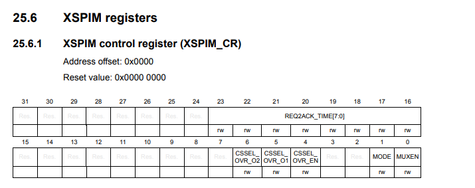

I think there is no EN bit in XSPIM_CR:
 You are absolutely right, there is no such register; I was negligent and meant the MUXEN.
I think what I mean to ask is: The XSPIM has to be enabled (clock on AHB5) for the XSPI signals to be available?
Thanks again!

The MUXEN bit is used to enable multiplexed mode.

Hi @KDJEM.1 ,
yes, thanks. This answers my question.
The gist is: if the XSPI is used the XSPIM clock must be enabled.
Or, conversely: if the XSPIM clock is disabled, the XSPI cannot be used.
