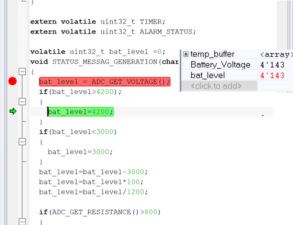

Many times i get into problems that I should not get into, like simple logical mistakes while executing code:
examples:
uint32_t a = 1;
if(a==1)
    MCU goes here, it's how it should be;
else
  MCU goes also here , how is this possible?;
MY latest problem I was generating string from battery voltage;
bat_level = ADC_GET_VOLTAGE();
  if(bat_level>4200);
    bat_level=4200;
  if(bat_level<3000)
    bat_level=3000;
  bat_level=bat_level-3000;
  bat_level=bat_level*100;
  bat_level=bat_level/1200;
And I always get 100%, even if my voltage is 3300 ( 1bit = 1mV)
And when debugging this part of code showed me why, I always make if compare and set 4200mV !!!
How is this possible? What I am doing wrong. (new iar arm compiler 9.10.2 with optimization on)

You have a semicolon at the end of your if statement. It always forces bat_level to change to 4200.

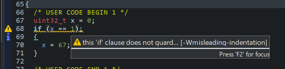

The best defense against obviously incorrect but technically compileable code is an IDE that detects these types of mistakes.
Both CLion and STM32CubeIDE detected your syntax was not intended.

Problem is with scaling logic not been corectly executed based on what I write. it works ok with zero optimization.
0693W00000Bax11QAB.png First bat_level was declared inside function, it give same results, when made it global, after that volatile, no results...
Ok, now I see the problem. simple mistype after if() ;

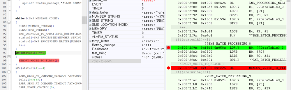

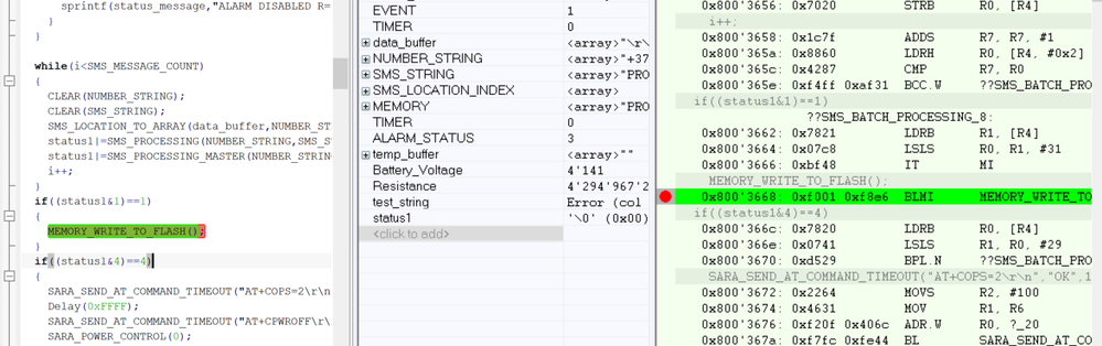

This is another example. Even if status is 0, and I can check it with debugger, it always goes inside if true condition, and updates my flash from ram.
0693W00000BbJ3HQAV.pngThis is with high optimization, no matter what I do, it allays does that...
with no optimization works just fine !
0693W00000BbJ3vQAF.pngSo where is my mistake ?
