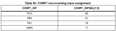

For COMP1 on STM32G0 here are the pin assignments from the reference manual
I want PA1 and so I've chosen that in the STM32CubeMX

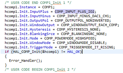

However, the generated code sets
and the value of InputPlus is

Which apparently maps to PB2 which is wrong!

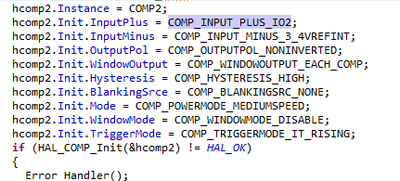

On the other hand, COMP2 I have chosen PB6 and its getting
Which in this case happens to be right!?
Any idea what is going on? I regenerated and get the same thing.

I changed COMP1 to PB2 and it stayed as is which is correct. Then I changed back to PA1 but the input did not change. And so it must be wrong!
