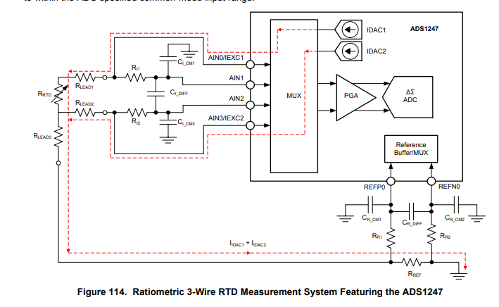

Hello I ask to help check if all right with my code, this is my first SPI...
I have use ADC1247 and seems it alive and responce for me by some of data, but ADC is sending something like "I see some of load" or "I dont see nothing". This is for 4 wire PT100 temperature sensor. Will be good to be shure that's code is right and then will check again shematic... Thanks for any of help...

AScha.3
R14 ... seem useless in this position, except wasting some current.
YShe.1
The value of resistor is 820 ohms as requed by data sheet. And schematic also from it. I trying to figure out what can be wrong.
AScha.3
should be this ...?
YShe.1
Yes this is 3 wire connection of RTD PT100. Any way it's not working even in 3 wire mode.
I have changed Rref from 820 ohms to 4.7 kohm and value unpredictable and jumping...
