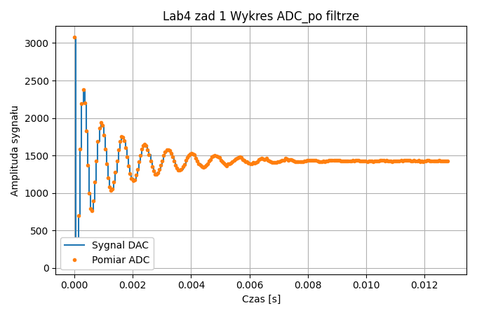

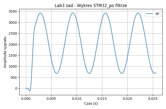

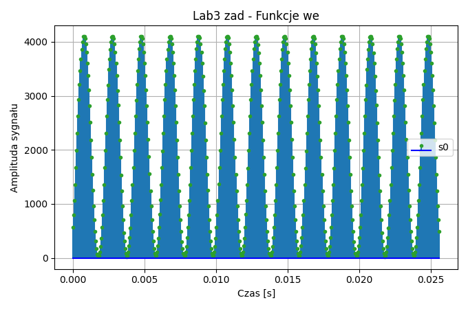

I am working with CMSIS DSP alghoritms and currently I get stuck with FIR and iir filters
When data are predefined in float32_t arrays everything works fine like bellow for FIR lpf
0693W00000UnRdmQAF.png0693W00000UnRdrQAF.pngBut when i am trying to use the same filter for array from ADC it looks like below (something wierd on right side of second graph):

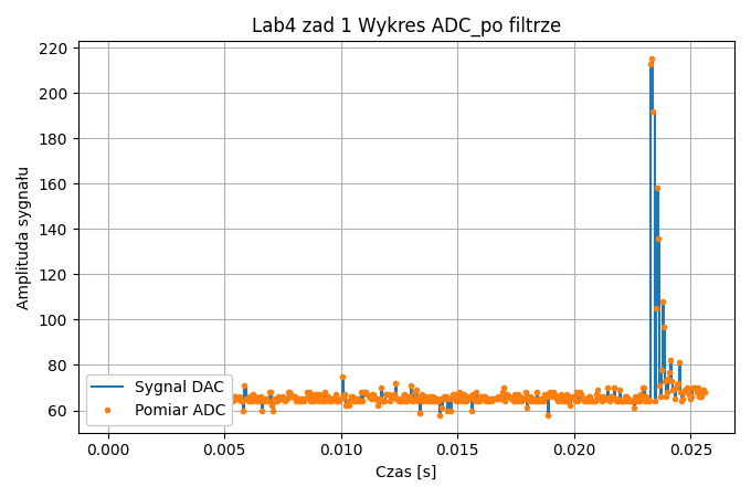

0693W00000UnReBQAV.png0693W00000UnRe6QAF.pngSame input data for hpf IIR filter and again something wierd on right side of graph

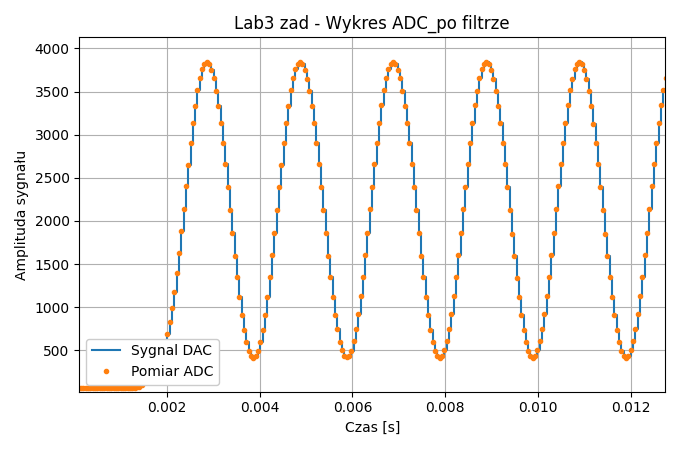

@Andreas Köpke​ ​ I am working on STM32F746ZG board. Back to subject - my enthusiasm was to quick- results looked good but it only seems to be right one- it is probably my lack of knowledge about regisers. Anyway- i found the reason of error. In my code I am sampling an array then stop ADC, count FIR / IIR and send it through DAC with circular mode. Problem was ADC restart- because of time delay sampling was initialized somewhere in middle of DAC cycle.
Solution was to start ADC and DAC line by line and lift up IIR response cos it shows only positive values. Now results for lpf FIR and hpf IIR looks like below.
