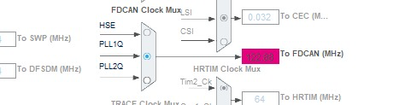

good morning. I want to implement a can loopback on my STM32H755, but when I enable FCAN1, then my clock can't resolve it issues and shows this for FDCAN in the picture below. how could I resolve this problem?

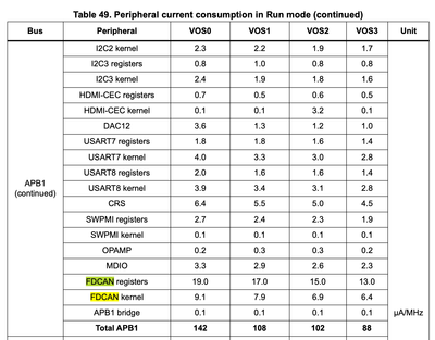

No these are the values for the power consumption.

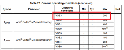

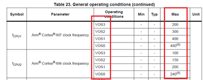

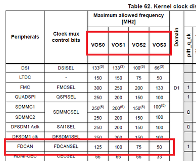

You need to set the voltage scale according to the system frequency, from DS12919 Rev 2:

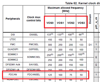

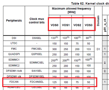

Based on that voltage scale (VOS) level, you can know what is the maximum allowed kernel clock frequency you can set for FDCAN:

You set a System clock from HSI at 64MHz.
This frequency corresponds to VOS3 since 64MHz < 200MHz:
And from this table:
The maximum kernel frequency for FDCAN is 50MHz for VOS3:

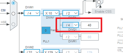

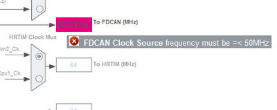

And this is the error pop-up from CubeMx is showing indicating that the max FDCAN ker clock is 50MHz which corresponds to what mentioned in the datasheet:
So, need either to increase the system clock by using the PLL or set PLL1 DIVQ1 to 4 so the FDCAN ker clock will be @40MHz.

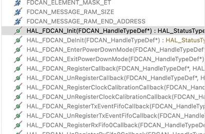

thank you for the response, I put 50 mHz for the fdCAN and I took an external crystal clock. unfortunately, when I access the hal_fdcan document I do not understand why my functions are crossed
Sorry I didn't understand your last question. Which document? What you are showning is the project browser menu. You need to set FDCAN at least in one Core and Activate it and then compile.
If it persists, please open a new thread.
