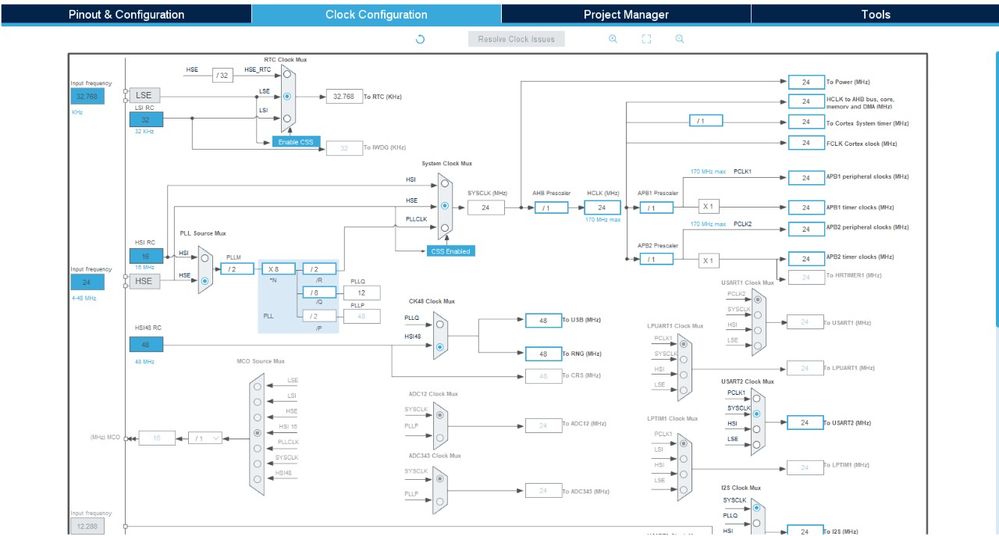

> My target frequency is 2.048 MHz, but CubeMX is not allowing me to set this value
Show.

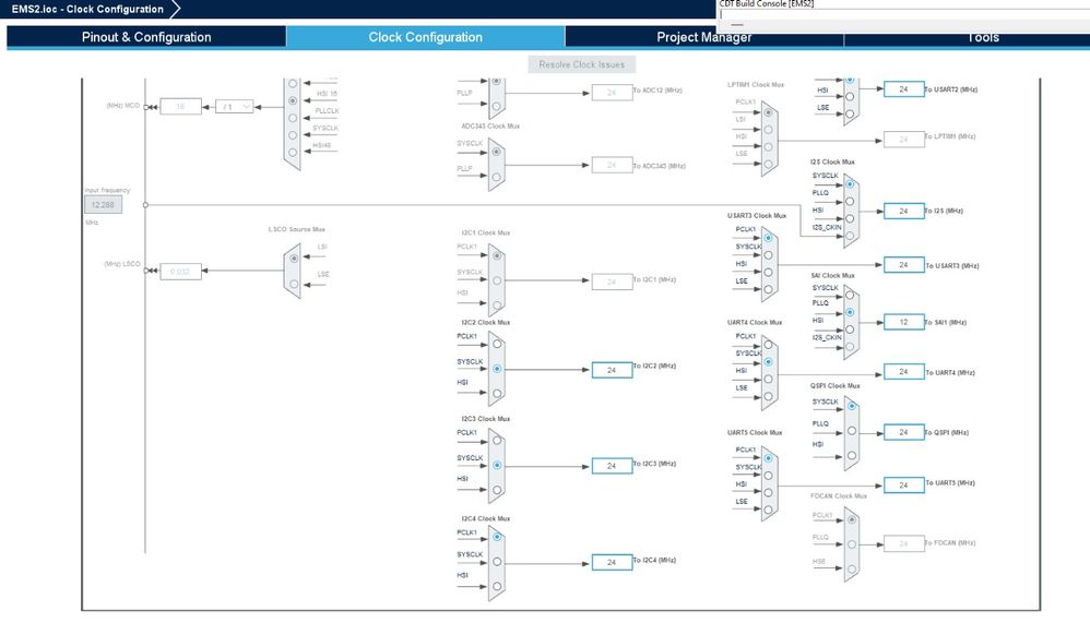

‎2024-10-13 2:36 AM
Here's the screenshots for the same!

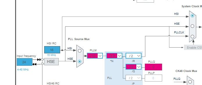

‎2024-10-13 5:38 AM
SAI uses integer divider. You can't divide 24MHz to 2.048MHz. 2MHz should be viable though.

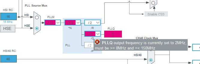

We are getting error "PLLQ output frequency is currently set to 2Mhz, must be >= 8Mhz and =<150Mhz." Please see the screenshot.
How do we modify this limit?
‎2024-10-13 6:13 AM
Use the MCKDIV divider in SAI.
