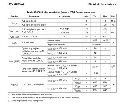

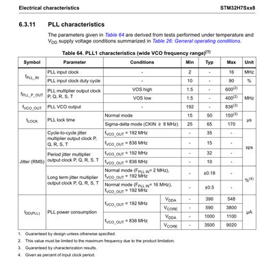

The VCO range has 2 version in STM32H7R7 RM, so which is correct?

Thank you very much for posting the question , VCOL is correct but VCOH the right ranges are in product datasheet here :
https://www.st.com/resource/en/datasheet/stm32h7s3a8.pdf#page198
we should fix the Reference Manual and make a reference to the datasheet.
 look at row : fVCO_OUT for Wide range table 64.
just saw another typo in Table65 in datasheet for IDD(PLL) last raw condition should be 420MHz not 836MHz . We should fix as well
