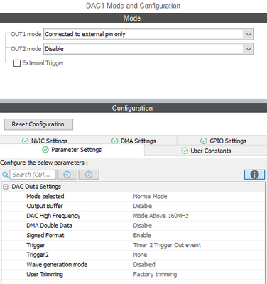

2.) Proving a DAC sync using the
  • Timer 2 Trigger Out event

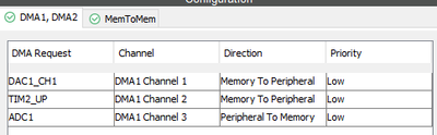

4.) Provide a GPIO DMA stream event using
  • TIM2_UP

TIM2 settings:
DAC settings:
DMA Settings:

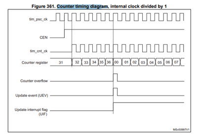

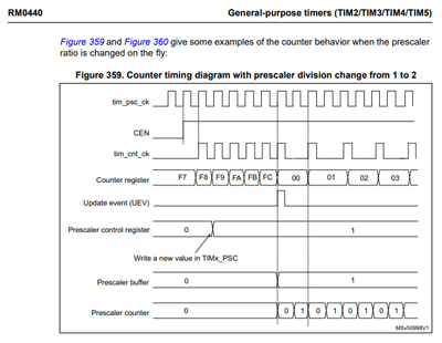

OK Based on this diagram:
I get why I get one PWM pulse before the first other signal, since a UEV is not generated when the timer first starts.
So that makes sense. i.e. it has to go through a full counter cycle (causing one PWM output) before it resets for the first time to generate the first update event, which is then when the first DMA signal is generated.
But that still doesn't explain why TRGO and TIMx_UP signals don't fire simultaneously, which makes the GPIO output and DAC outputs different, with the DAC lagging by 1 Update event.

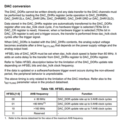

probably this
HFSEL bits of DAC_MCR must be set when dac_hclk clock speed is faster than 80 MHz. It
adds an extra delay to the transfer from DAC_DHRx register to DAC_DORx register.
Thank you SO MUCH @Hakuki_Riumiya for the first decent suggestion as to what the this might be!
I'll try this tonight and report back here if it fixes the issue.
Thank you!

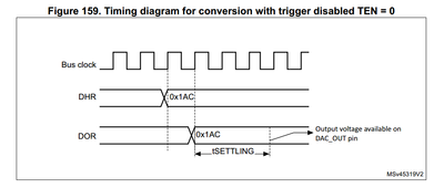

The DAC triggers DMA request only after it has transferred value from DAC_DHRx to DAC_DORx as a consequence of trigger. It means, that the first trigger - i.e. in your case first timer Update event - transfers the default value of DHR to DOR (i.e. remains at zero), and only after that the first DMA transfer is triggered, which transfers the first datum from memory to DAC_DHR, which then gets output to DAC_DOR only after the second trigger. Read DMA requests subchapter of DAC chapter in RM, this mechanism is described there, together with the solution (i.e. transfer the first value to DAC_DHR before enabling the trigger source i.e. timer, "manually").
