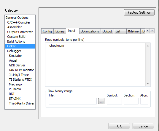

Dear STM32 users,
I want to add a checksum to my application in such way I can every let's say 100 seconds check the flash integrity using CRC.
I have found that IAR simplifies this task and can add at the final adress (or other specified locations) the CRC of the application.
I refer to the techical note 11927 Checksum calculation with IELFTOOL after linking with ILINK
http://supp.iar.com/Support/?note=11927&from=search+result
and the provided examples:
http://supp.iar.com/FilesPublic/SUPPORT/003588/Check_Sum_511.zip
I am following the steps in this tech note and I stuck here:
Add usage of the symbol __checksum in your application
In fact I don't understand what does mean ''add usage of the symbol......''
When I declare it as following:
unsigned short __checksum;
I got thsi error message:
Error[Li006]: duplicate definitions for ''__checksum''; in ''C:\.....\checksum\Obj\main.o'', and ''Place holder __checksum''
When I declare it as following as done in the example provided by IAR:
extern unsigned short __checksum;
I got this error message:
ielftool error: The string '__checksum' was not found in the string table
Is there someone who can help me on this? and thank you in advance.

tbenson
Posted on August 09, 2011 at 18:47
Here are the settings I used in IAR to get the checksum to match the STM32-generated one (note that your addresses will be different depending on your application):
Also see http://supp.iar.com/Support/?Note=11927

tbenson
Posted on August 09, 2011 at 22:54
Make sure you add the __checksum symbol to the Input dialog as shown below:
I'm heading out for vacation now, so good luck :)
