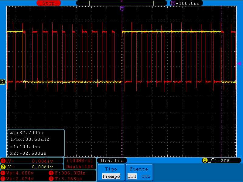

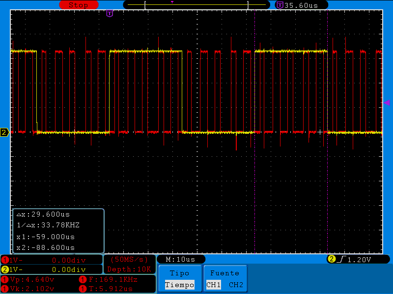

I need a 5-pulse modulation to attack two drivers with a resonant tank to create a sinusoidal.
I have these 5 pulses created with DMA with TIM_CounterMode_Up, if I set them as TIM_CounterMode_CenterAligned3 I get 3 instead of 5. How can i fix this? -5 pulses, but reading only 3 values of the table: 0690X00000602QzQAI.bmp 5 pulses reading the 5 values, but i cant fix the square signal to fit only 5 values inside: 0690X00000602R4QAI.bmp

How can I put both onTIM_CounterMode_CenterAligned3, having the 5 values of the table instead 3 Ihave now? #stm32f103-pwm #center-aligned-pwm #pwm

What are those waveforms?
Posted on March 02, 2017 at 08:18
Red signal: modulation, based on the tim3A[5] array.
Yellow signal: channel selector, for switching the drivers.
The problem is that when I set it as center aligned, instead of reading the 5 data from the array it only reads 3.
Posted on March 02, 2017 at 22:53
I mean, which STM32Fxx pins did you measure by the oscilloscope?
Posted on March 03, 2017 at 08:10
The square signals are on PA6 and PA7 (one inverted).
And the modulation is on PA8
