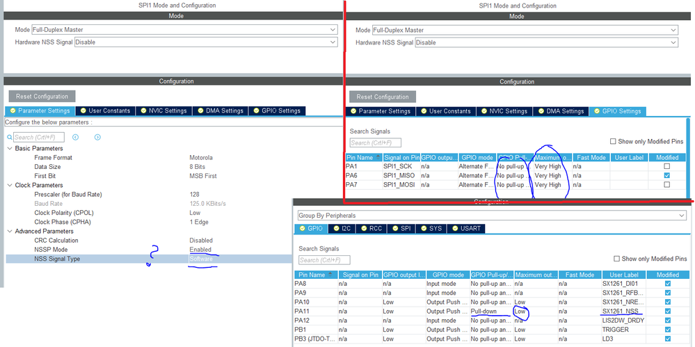

2020-08-15 11:25 AM
Not sure what the problem is exactly but it doesn't look like the nss line is being handled properly. Is it toggleing during the transmission?

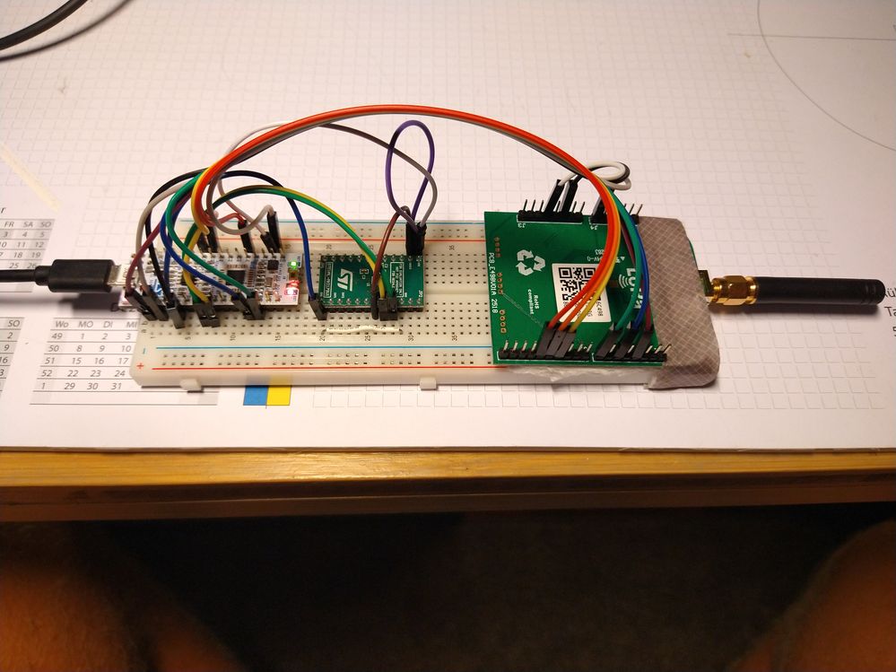

2020-08-17 10:33 AM
alright, looks like i found the problem : is that a typical "breadboard" problem ? my project looks like that:
How should i handle my NSS ? Can it be controlled by the HAL driver?
I tried to lower the Frequency and a PullDown at my NSS GPIO..
should i change something here ?
the GPIOs have a optoion called Max output frequency .. are that configurable low passes ? should i use that ?
Or Should i just solder my circuit onto a perfboard and get rid of this breadboard?
Thank you guys!

2020-08-18 2:48 PM
Well, there are a dozen options that come into my mind which all may have an impact, more or less.
(1) A breadboard is not necessarily worse than a PCB. Depends on the layout. On your breadboard you should feed VCC and GND to the + and - lines at the edge of the board. Connect all your parts / Mini-PCBs there and decouple your supply properly, e.g. by adding 10 .. 100uF capacitors between VCC and GND. BTW I hope that the backside of the pin headers of your LoRa-PCB do not hit the + contact line of your breadboard else they all would be shortened...
(2) I would feed at least the SPI signals individually from the STM32 to the SX1261. Currently you have put them together in a wiring harness which increases coupling between signals.
(3) Adjust your oscilloscope settings. Even when you're using 10:1 probes (which is good for high-speed signals) the scope software can be told which probe is connected so that voltages are scaled right. And connect the GND lines of your probes to the common GND as described above.
(4) As already suggested by TDK go back to 8 bit transaction and show a single SPI transaction. On your current screenshots one can only see the time distance between transactions, but one can only imagine how the signal looks like for a single byte.
It would be best to have the SCK and MOSI signal on screen to see the timing relationship. Make sure that your signal looks like in chapter 8.2.1 of the SX2161 datasheet (e.g. MOSI shall change state at the falling edge of SCK, SCK freq. <= 16 MHz with 50% dutycycle, else slower).
(5) Resistors on SPI lines are not needed, the STM32 has push-pull-drivers (assuming that the same VCC is used for the SX1261 and the STM32). Don't use the "max output frequency" option if not needed as this shortens the signals edge time (by a stronger driver) and in consequence generates a higher overshoot.
(6) The overshoots in your screenshots may be measurement artifacts due to poor GND connection of your probes. Make these as short as possible.
(7) The NOP command used during reads is defined as 0x00, not 0xFF, in the SX1261 datasheet. No clue if that matters when doing a read transaction.
(8) The Arduino is quite slow, due to CPU speed and hardware abstraction layers. Maybe that "helps" that your code is running there. The SX1261 as most Semtech chips incorporates various modes to save power, some of them are switched automatically but this takes time. For instance you have to wait at least 150us after the falling edge of NSS before you start the SPI clock on SCK. Either by waiting long enough, or by checking the BUSY signal of the chip.
If nothing helps, provide the high-res. scope screenshots for further analysis.
