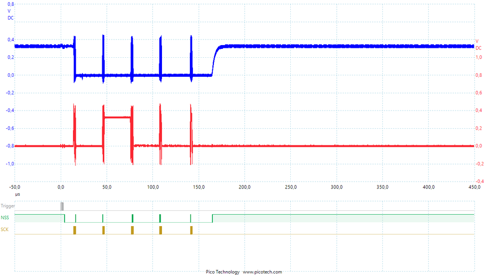

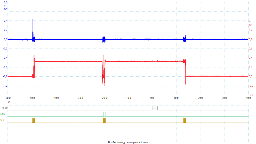

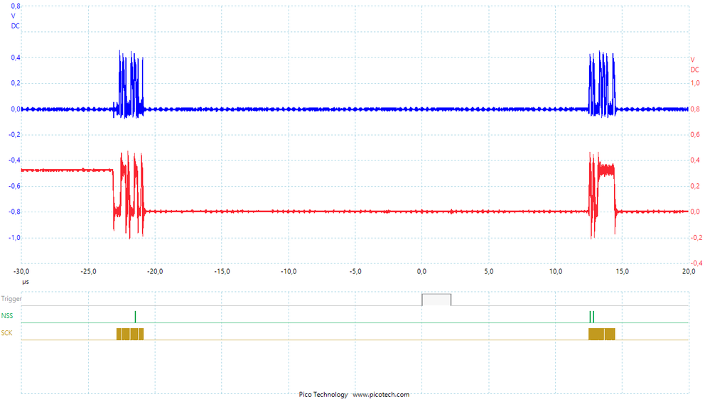

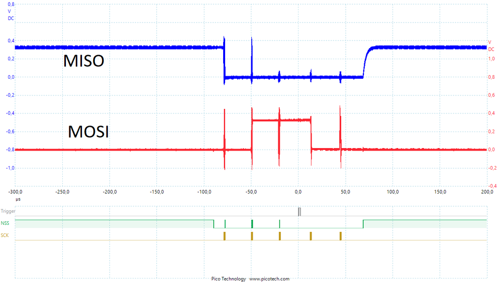

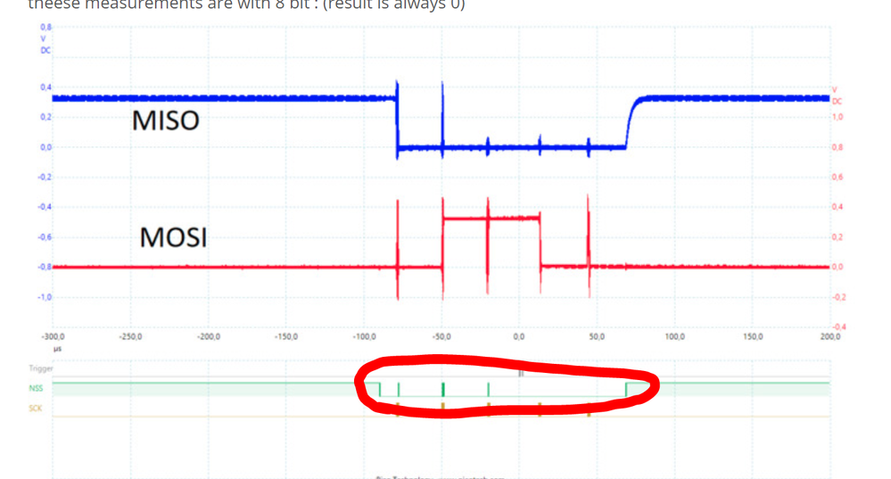

i just hooked my Oscilloscope to the SPI lines .. the voltage levels on MISO seem to drop if i change SPI_DATASIZE_16BIT; to 8 BIT .. why is that?
theese measurements are with 8 bit : (result is always 0)
the next 2 pictures is with the same code, but the Data_length changed to 16 (wich gives me wrong results (bit not 0)):
i hope this helps ..
Guru
Your scope is suggesting the voltage level is ~0.33V. Are you using probes in 1x mode instead of 10x mode?
Why are you using SPI_DATASIZE_16BIT at all? If you want to send 8 bits per transaction, use 8 bits per transaction.
Your NSS line is toggling mid-transaction. That's no good. Could be noise.
In any case, you're going to need to zoom in on MOSI/SCK closer to see values of individual bits. If those bits are correct, then the STM32 code is not the problem and there is some other reason the IC is not responding correctly.
