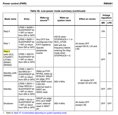

Sarra.S
This is the table you should refer to, to know the wake up capabilities in every low power mode:

Thanks for the info, but it only shows me that it should work as I have explained it. But if there is something I overlooked, it's not there.
I have checked in the reference manual and have seen that any activated EXTI line is also activated as a wakeup source, no matter if it's event or interrupt based. So I'm still stumped.
