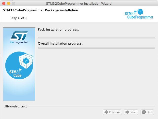

I'm having troubles installing STM32Cube Programmer under MAC - High Sierra, recently formatted.
The installation process starts regularly and then freezes forever!
Can anyone help me??

    Hi Giulio,
    Can you please give us your java version ? java -version and please indicate in which step you are observing the freeze.

    Ciao Aymen,
    Thanks for your reply!!
    Here's the output of the query.
    java version ''9.0.1''
    Java(TM) SE Runtime Environment (build 9.0.1+11)
    Java HotSpot(TM) 64-Bit Server VM (build 9.0.1+11, mixed mode).
    The installation freezes at the very beginning.
    Thanks in advance for your support:-)

    Hi Giulio,
    Java9 is not yet supported by MAC installer. You have to install java8 if you want to use STM32CubeProgrammer.
