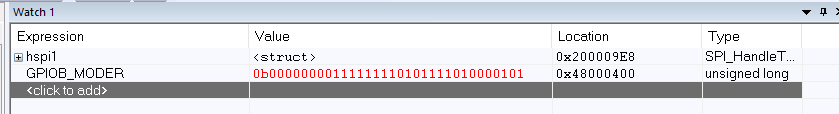

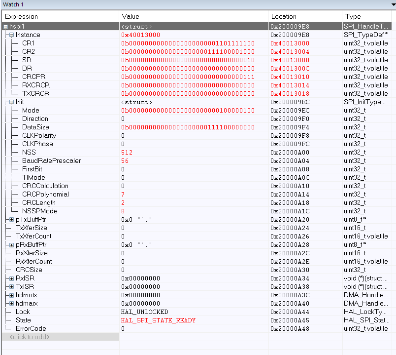

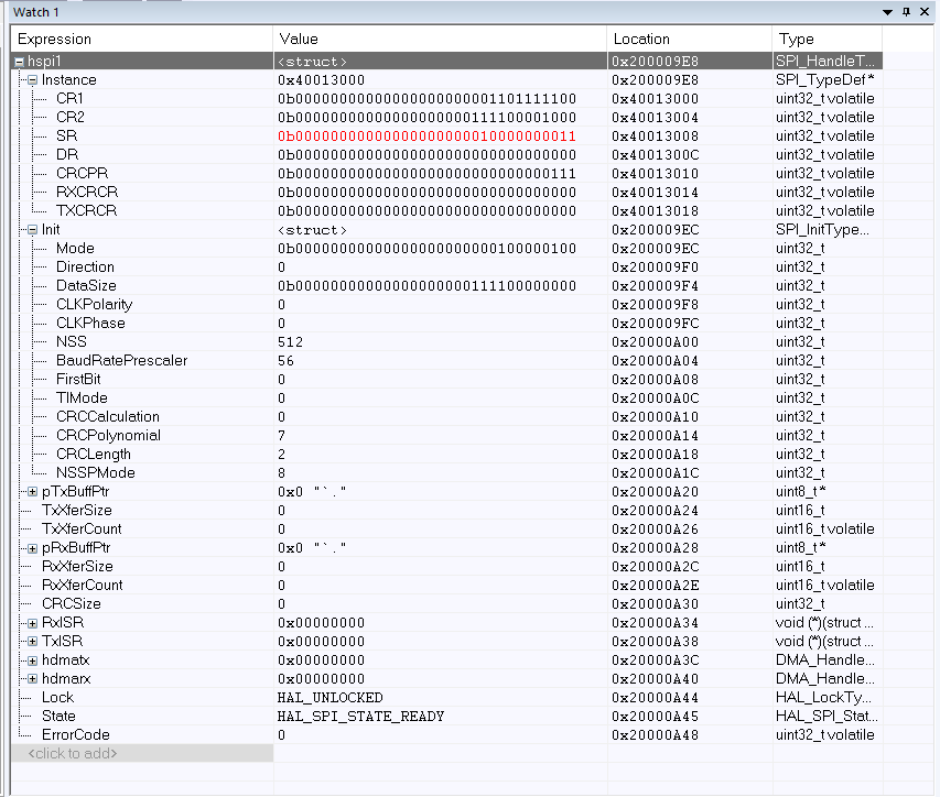

BMart.2
BMart.2Author
May 22, 2020

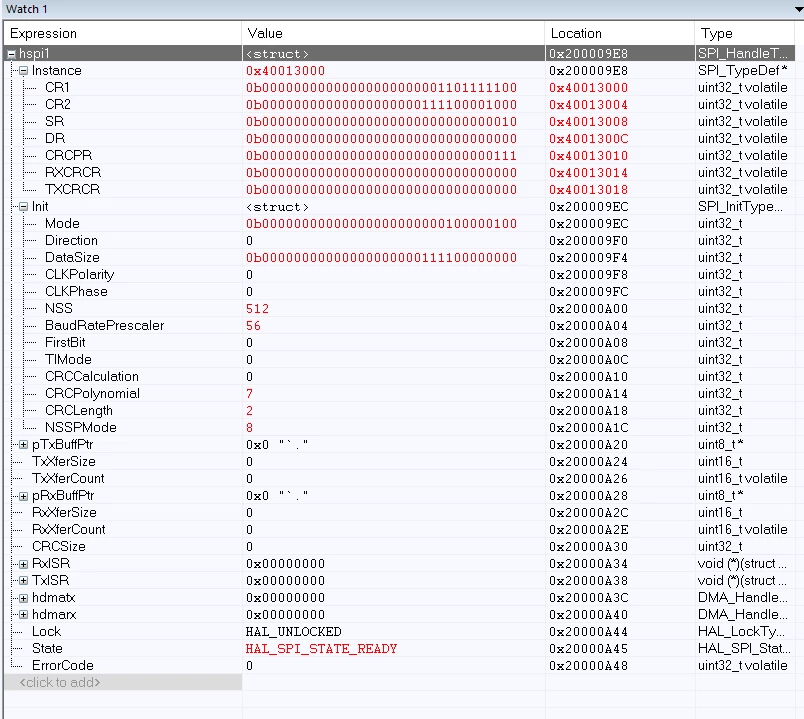

Just before while 1 after spi init
after 1st LL_SPI_TransmitData16 call, breakpoint on ubNbDataToTransmit--.0693W000001pKNkQAM.png
Not real sure how to read/show the relevant GPIO regs.

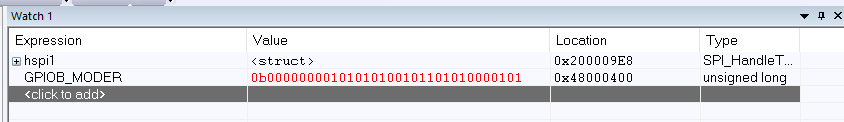

BMart.2
BMart.2Author
May 22, 2020
Just shown portb mode register here which is relevant to the spi being tagged to PB3, PB4, and PB5 I think.
Just after MX_GPIO_Init() not shown but toward the start of main.0693W000001pKPlQAM.png
Just after MX_SPI1_Init().

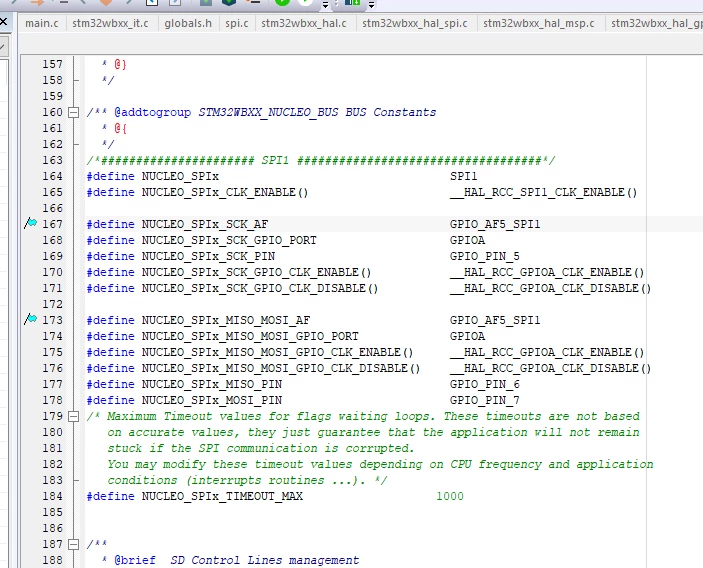

Could this be the issue? This is from header file stm32wbxx_nucleo.h. Do I need to redefine from GPIO A to GPIO B here and the relevant pins?

The binary numbers are extremely hard to read, next time please use hexadecimal.
GPIO_MODER looks good, AF set for PB3, 4, 5; but you did not post the AFR register's content.
SPI registers look good, the fact that RXNE is set after the transmit function makes me believe that the clock is output to physical SCK pin (otherwise the receiver in other STM32 SPIs does not work; I doubt the 'WB is an exception).

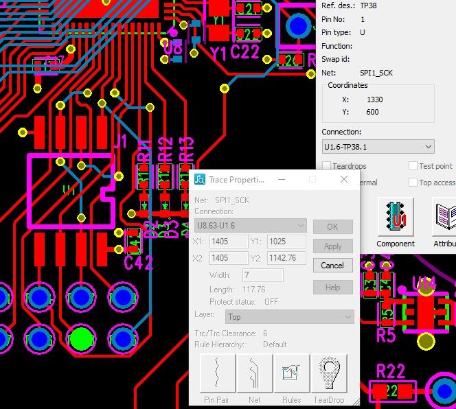

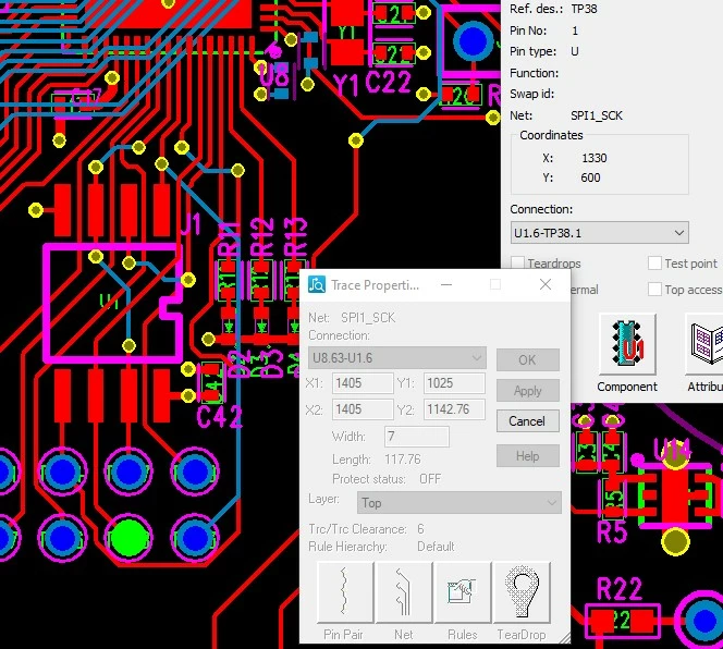

Did you observe the pins directly on the package? Isn't there a jumper or solder bridge on the board which you overlooked? See schematics and board manual.

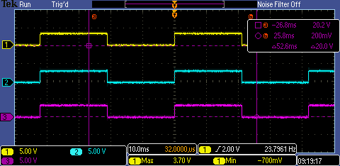

Ok, I took the same CubeMx file and disabled spi1 and made PB3,4,5 outputs so I could toggle them. I added the code shown below

And on the test points on the board I measured the following on PB3, 4, and 5. I’ve ohmed each pin to each other plus to ground and surrounding pins and no shorts so I’m confident the hardware is ok.

Nope, that didn’t work. But I found out what the issue was.
When I built the project with CubeMx I compared it to the project in the repository. That project had the BSP directory included which I think was messing up the CubeMx generated setup of the HAL.
I originally had this
Which would not work.
When I removed the file stm32wbxx_nucleo.c from the project like this
It works with LL and hspi1.Instance->DR.
I was trying to get away from the nucleo bsp but to get it running I added the bsp/file to my project thinking I needed it.
