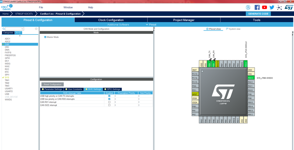

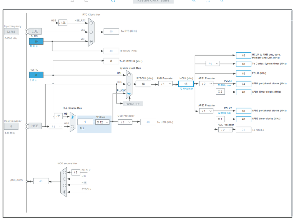

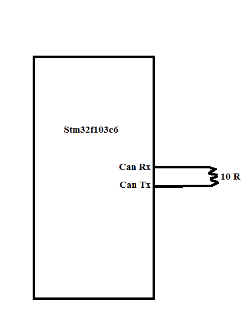

I made a simple connection like in the figure. The processor's Tx pin is connected to the Rx pin. When I look through the oscilloscope, I can see the data flowing.

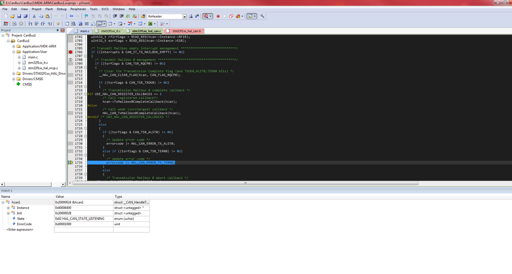

When I debug code :
It goes to the error code in the picture during tx.
Code:

The code does not go to the functions "USB_LP_CAN1_RX0_IRQHandler" and "HAL_CAN_RxFifo0MsgPendingCallback". Where am I making a mistake?
