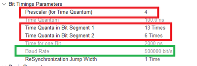

Hello I am trying to attempt a CANBUS communication between two different STM boards, I've been following the videos on the STM website as a reference and I got the LOOPBACK Mode to work with one STM board but I am having trouble getting the NORMAL mode to work with two Stm boards.

I told you to change the CAN prescaler value as well as BS1 and BS2 values as they are not safe? did you do that?

Just noticed that the video you're watching doesn't seem to use the same boards as you! Moreover, there are some "bubull**bleep**":
- Nucleo board doesn't have a Crystal mounted on it while he selected Crystal / HSE as system source clock.
- The CAN parameters are not safe: prescaler, BSA, and BS2.
I don't know how this worked for him!!
According to Nucleo-L4A6ZG and Nucleo-L4R5ZI-P schematics, there is no crystal external mounted on the boards. The only solution you have is to use the clock generated by STLink (MCO).
So, according to the schematic, you have to solder SB109 as well as SB148 to connect MCO output from STLink to OSC-IN of the STM32L4xx.
Also you have to configure HSE in bypass mode.
I've attached CubeMx project for STM32L4A6ZG: clock at 80Mhz, CAN bitrate at 500kb/s with reasonable parameters:
You can do the same thing for STM32L4R5ZI.
Hope it helps you.

First, IT'S NOT RECOMMENDED to use any internal clock source for CAN communication i.e. HSI, MSI etc.
Second, you said "I soldered the SB109 to SB148"! what do you mean by "to"? you soldered all the solder bridges from SB109 to SB148 or soldered SB109 to SB148? the idea is to solder SB109 AND SB148. Please refer to your board schematics to understand the modification and the idea behind.
Third, the idea of soldering SB109 to SB148 is to connect the external clock source generated by the STLink to OSC-IN. But when you say you are configuring MSI as source clock, soldering SB109 and SB148 has no effect.
I tried to attach the .ioc file for you but did not succeed due to a limitation on the new forum (I raised the issue internally, hope it will be fixed asap).
So I'm attaching the screen shot of the clock config.
