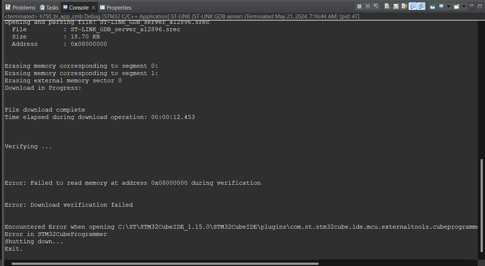

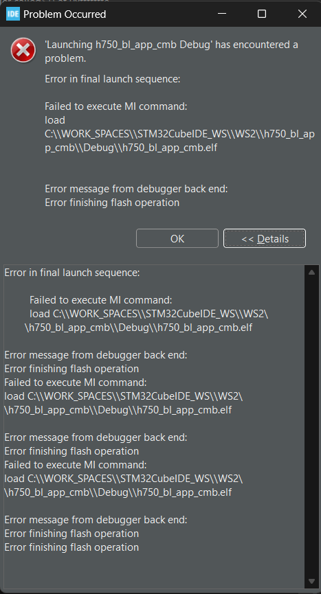

There is still a problem uploading the code
I used the appropriate external loader from the repo you suggested (it works on its own without any problems)
