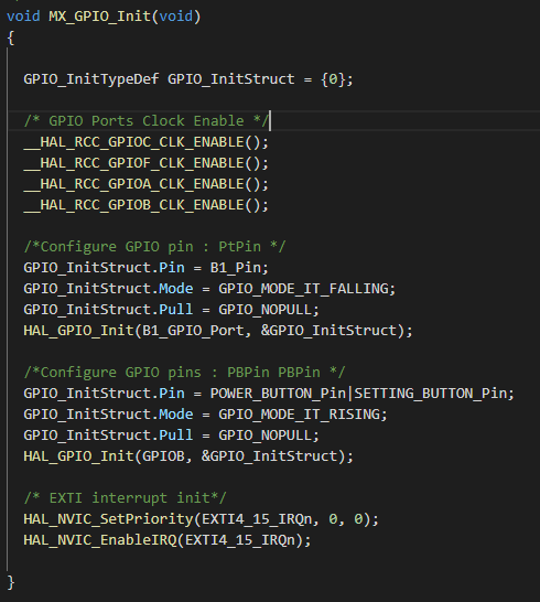

gpio.c generated from STM32Cube:

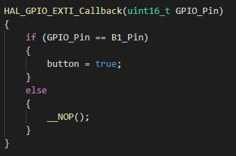

Callback function, as shown in the video, present in main.c:

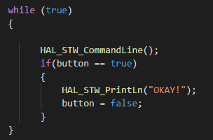

Using the boolean the interrupt *should* set. The CommandLine() function is not blocking (even if it was, it shouldn't matter anyway, if this is an interrupt) and the PrintLn function I have made works perfectly fine (just based on normal HAL_UART_Transmit(), with an added \r\n).0690X000006CmE2QAK.png

Sorry. It was actually a problem with my programmer/ELF file. It turned out for some reason the new compiled hex/bin (which had the interrupt implemented) wasn't getting flashed, and so things weren't working before. The code I have posted does in fact work.
