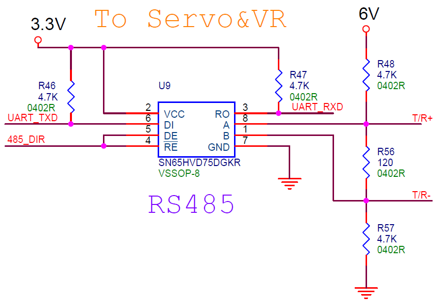

I am using STM32F303CB to build a modbus environment which connected to RS485 bus.
(BTW, MCU as slave side)
I using STM32 HAL lib to setup whole UART & RS485 setting.

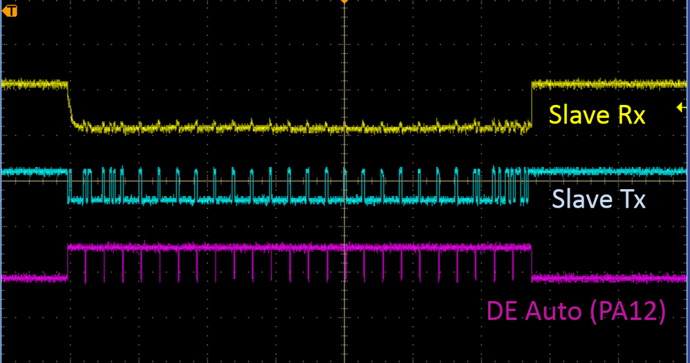

I suppose DE pin waveform should be matched to Slave_Tx ( X wrong)
-> The DE pin waveform should be driven to high until Tx send out data.
The DE pin is likely a periodic pulses. (That was strange)
My Schematic is as follow (485_DIR = DE)

What do you mean by "match" in "DE pin waveform is not matching to salve_Tx waveform"? DE should be active during the whole duration of transmitted frames (transmitted bytes), and it appears to be so. It of course cannot be identical to Tx.

@JW Yes, you are right ( DE should be active during the whole duration of transmitted frames), even though, my DE still wrong.

I finally got the reason, cause I am using freeModbus lib, it will turn off interrupt when Rx or Tx done.
That will cause this phenomenon.
