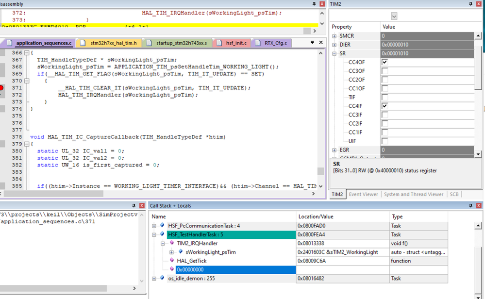

I am trying to find the duty cycle of a incoming PWM. And my problem occurs when there is an interrupt and now the interrupt handler executes properly but It doesn't come back to the main task (os based). I am not getting hard fault or any kind of trouble. Where do you think I made a mistake.

when I check the value of duty cycle I can read the expected value but it is not coming back from irq handler.

‎2021-11-08 9:23 AM
Hi again,
If I remember well the HAL_TIM_IRQHandler(); doesn't expect that you check/clear for flags before calling it or the callback won't be called.
‎2021-11-08 9:33 AM
Hey, I didn't understand what you said? You mean to try with different frequencies?But this is the latest screenshot
‎2021-11-08 9:40 AM
But callback is not issue for me. Returning to main is the issue. The callback is working well. I was able to set breakpoint and check. But not going to main again.
