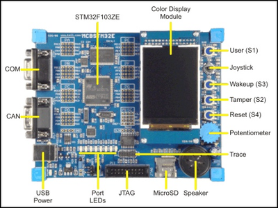

I'm learning STM32 with the board above and trying to program the ADC conversion.
However, when i start debug with keilC and observe the Adc value, nothing happen.

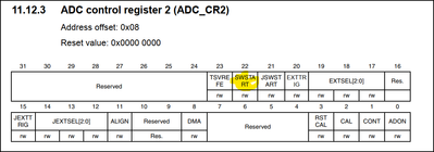

I check the ADC register and realized the SWSTART can not be set to start conversion process.

Read out and print the values in the ADC1 registers. Apart from SWSTART, do they match what you are expecting?
waclawek.jan
March 5, 2024
ADC_CR2.SWSTART starts conversion only if ADC_CR2.EXTSEL is set to 0b111.
Other remarks:
- you need to perform calibration first, otherwise results will be offset
- ADC_SR is to be cleared by direct assignment of 0, not &=
- sampling time setup is suspicious, I haven't checked which channel is it for but comment says different channel than selected for sequence
- you haven't finished the GPIO setup
