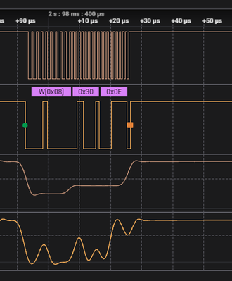

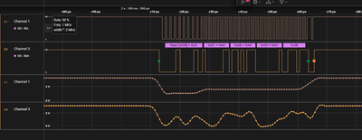

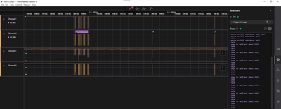

Hi @Foued_KH ,
 Thanks for your kind reply. Actually, I modified the example in the STM32H5 CubeFW I3C_Controller_InBandInterrupt_IT to control my device:
Here are the SDA and SCL behavior images detected by using Saleae:
After enabling my device (send data 0x0F to register 0x30), the device keeps sending IBI requests. But the program is blocked in the while loop of while (HAL_I3C_GetState(hi3c1) != HAL_I3C_STATE_READY), and I can still receive the IBI request.
once I use if ((start_addr==0x30)&(data[0]==0xF)) to avoid the while check loop, the program can keep running and I can process the IBI request on the controller side.
