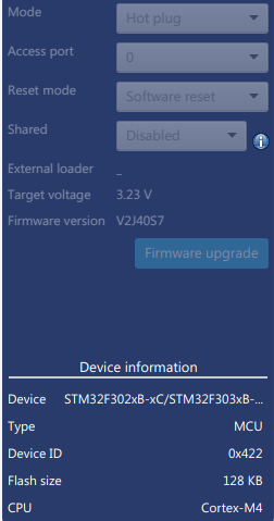

this is the bluepill-303
can you connect with stlink + Cubeprogrammer?
info:
‎2023-04-06 11:56 AM
I am using the Cube IDE. However, I am unable to connect to it. Even with the ST-Link utility, I am unable to establish a connection.
