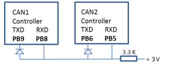

Hi.
I'm trying to make my STM32F4-Discovery talk to itsef through CAN,using this configuration 0690X00000605L3QAI.png and here's my code.

The first time I push the button, the program indicates that the message is successfully sent. CAN2 receives nothing however. HSE_Value is set to 8 MHz. Any insights would be appreciated. Thanks in advance. #stm32f4 #can #discovery
