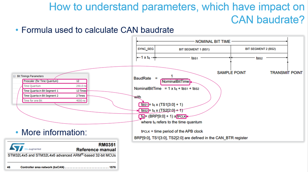

but, I want to learn
2018-03-27 7:54 AM
Sum of quanta, times prescaler, divided into APB clock the CAN is on.
2018-03-27 8:02 AM
The way how to calculate manually CAN baudrate you can find in MCU's reference manual, in chapter related to CAN interface. Please find below the part related to this subject and relationship between it and STM32CubeMX.
Regards
Szymon
