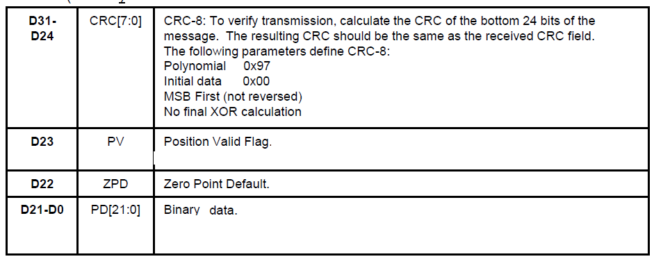

you assume that I have 4 variables such as Data1,Data2,Data3 and Data4 that store each byte (Data1 saves d24-d31 and Data4 stores D0-D7). So I want to know how can I execute Crc-8 algorithm in these data according to datasheet with SPL library. I would appreciate give me a simple source because I don't have any Idea How I can implement this algorithm form my input data.

    You'd need to compute in software, the hardware isn't going likely to do this for you.

    https://www.ien.eu/uploads/tx_etim/Page_24_25_Zettlex_42750.pdf
    You'd need to provide a couple of example packets.
    What is the final application here? Where will it be used?

    It isn't that complicated, would need a couple of 32-bit data patterns to validate.
    What is the final application here? Where will it be used? Please complete your profile accurately.

    Well , I have got these values:the first bytes are 000255,000098,000197
    000255,000225,000029,000033
    000098,000225,000029,000032
    000197,000225,000029,000034
    Actually I want to decrease and increase speed of a motor with getting valid data. but if my motor starts it tries to make a lot of noise that can destroy my input data. So I want to check crc code to be sure that each received characters are valid.

    Not able to make the maths work with those numbers..

    I don't know, post the link to the data sheet for the specific part you are using, and perhaps the logic analyzer output from the SPI transaction. The command/result phase might take 6 bytes of total transfer back/forth. Present the data as stream of 2 digit hex bytes rather than decimals, ie 0x11,0x22,0x33, etc.
    I don't have a way to replicate the hardware.
    I tried different initialization, shift direction, and polynomials. The manuals for these parts should provide specific byte/word sequence examples.

    you are right and it was my fault because my sensor model doesn't provide the CRC calculation and I thought the first byte it is related to CRC bytes.
