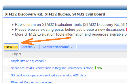

sorry for this interrupt.i am new in this forum.i don't know how to post my doubts.pls help me.
Posted on August 01, 2014 at 16:40
Sorry for this interrupt.i am new in this forum.i don't know how to post my doubts.pls help me.
