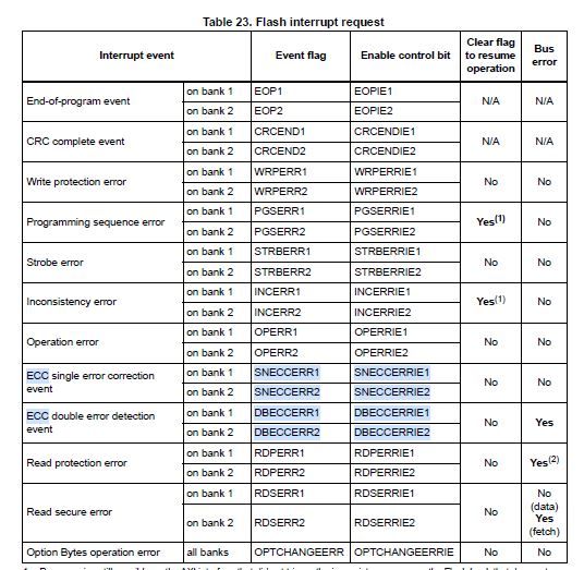

BusFault after Flash double-error detection and Flash IT not enabled
Gpeti
Senior II
I am wondering if a BusFault is triggered when a double error is detected but the Flash IT (or the DBERRECC event) is not enabled ?
