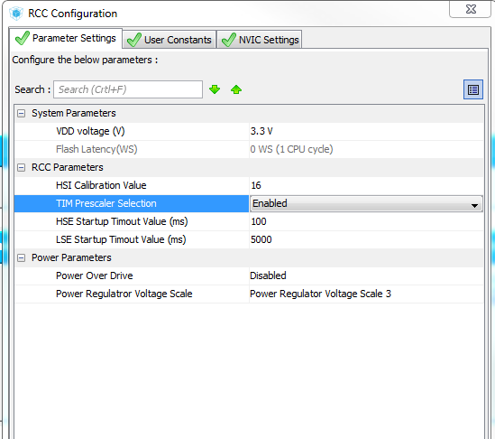

Please make sure that theTIM Prescaler selection is enabled from RCC configuration tab:
-Nesrine-
Posted on May 17, 2017 at 12:30
Dear Nesrine,
thanks for the hint. However when setting the frequency field for AHB1 timer clock to 200 Mhz, cube tries hard to find a solution, but does not come up with the  'TIM Prescaler selection from RCC configuration'.

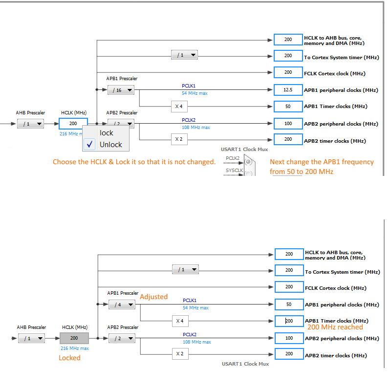

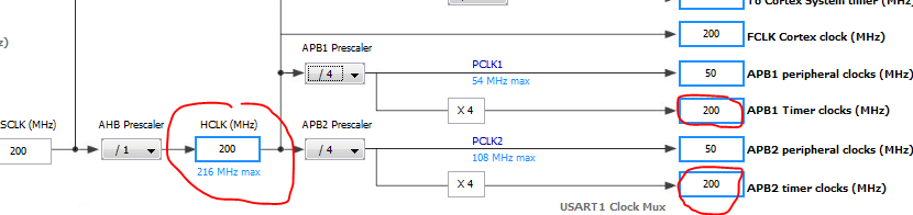

Dear Nesrine,
do it the other way round. Start with a new project, change to the clock configuration view, set up PLL to run at highest speed, correct all AHB/APB prescalers so that all bus speeds are in the limit. Now the ABPx timer clocks are twice the value of the corresponding ABPx clock. No change the APB1 timer clock frequency input field to the value of HCLK. Cube starts to find a solution, but does not come up with TIMPRE and offers no solution. Cube should consider TIMPRE in that case.

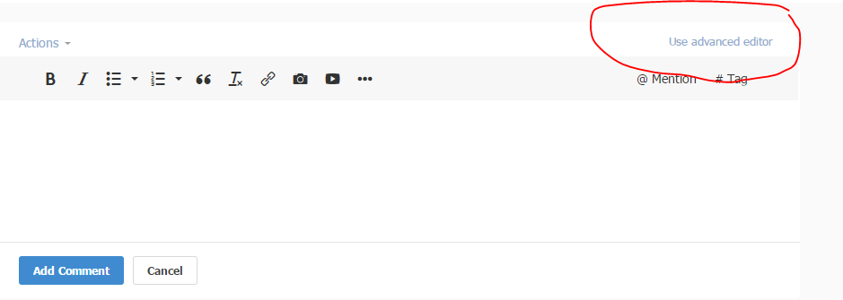

I don´t see a possibility on this page to share a file...
Posted on May 18, 2017 at 14:37
Hi
Bonnes.Uwe
Please use advenced editor

Posted on October 19, 2017 at 14:42
Please note the following feature on CubeMX clock tree. By right clicking the clock tree, you can lock a value you want to remain unchanged (HCLK here), then to reach 200MHz for the timer the timer pre-scaler will be adjusted fine0690X00000608YLQAY.png.
