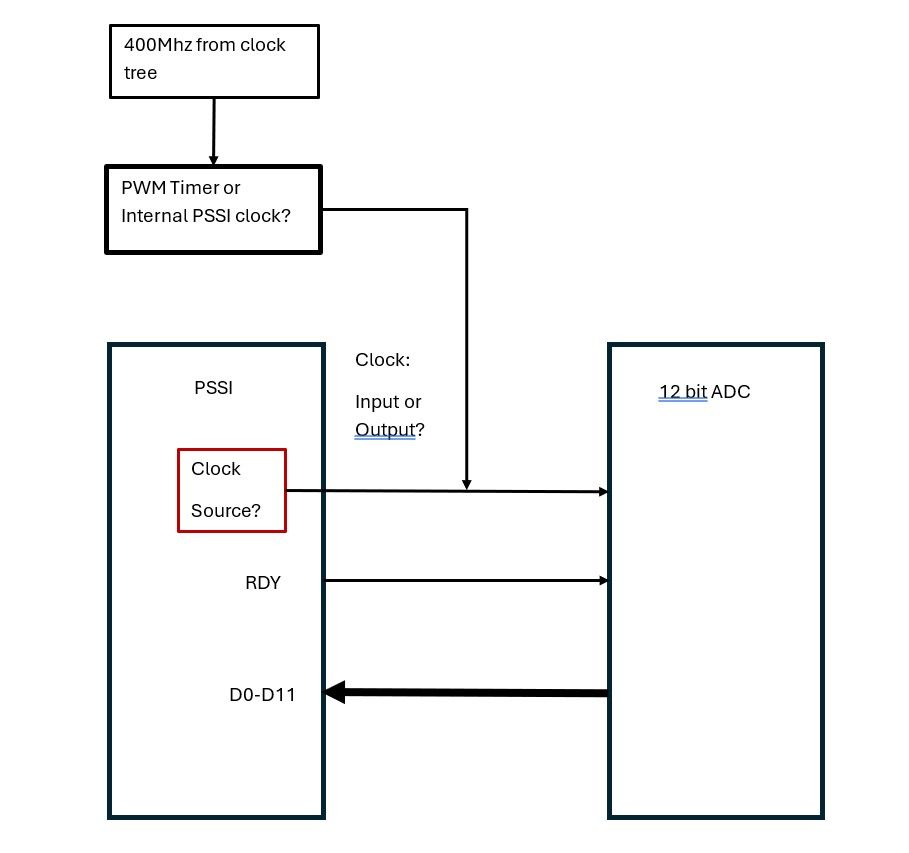

I would like to connect a 12-bit ADC operating at 10MSps to the PSSI interface of the STM32N657 device.  There is some confusion as to the nature of the clock source. The reference manual indicates that this may be either an input or an output.  If configured as an output, what is the source of the clock?  Examples suggest that a PWM timer needs to be used.  Here is an illustration of what I would like to do:PSSI Interface.jpg
Do I need to use the PWM timer as the clock source?

No, there isn't. The PSSI_PDCK pin must be connected to a clock source pin like as MCO pin, timer pin…

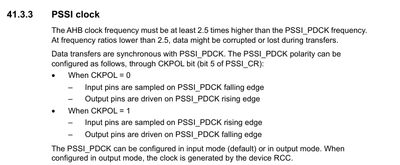

As mentioned in RM0486, the PSSI_PDCK can be configured in input mode (default) or in output mode. When
configured in output mode, the clock is generated by the device RCC.

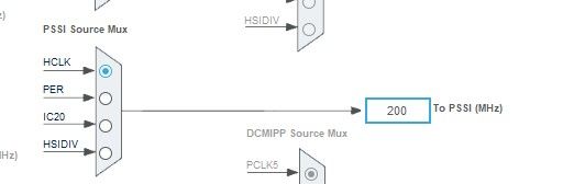

Ok, assuming that the RCC may be used to configure the PSSI clock, PSSI_PDCK, this is what I see in the clock configuration of STM32Cube:

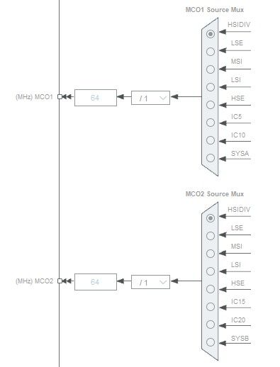

How does this signal drive the PSSI clock?  MC01 and MC02 have been mentioned, but are grayed-out:
How may the RCC be configured to drive the PSSI clock pin?  Is there a tutorial on configuring the RCC?

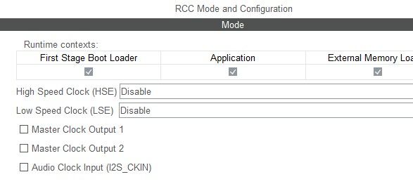

Does this have anything to do with PSSI_PDCK:

You need to enable the MCO in the Pinout  Configuration.
Then choose the clock source and configure the MCO1 frequency.
Finally, connect PSSI_PDCK pin to MCO pin.
Please look at this How can I output a clock signal to the STM32’s MCO pin? may help you to configure the MCO.
