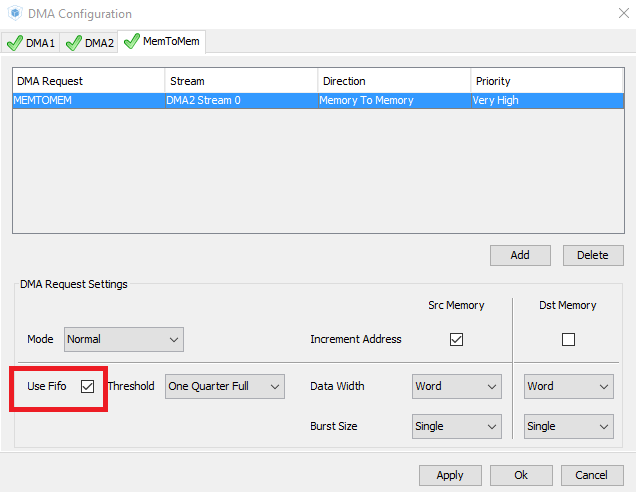

Using CubeMX version 4.16.0 with DMA it does not let you turn off FIFO mode. The check mark does not deselect.

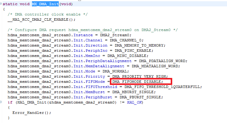

The generated source code needs to be manually modified to turn off FIFO. After the following change the DMA works properly.

Hi yarema.andriy ,
Could you please precise which STM32 product are using? So that it will be easier to verify the issue?

Posted on August 11, 2016 at 19:06
The CubeMX is used to generate code for the STM32F767 Nucleo Board. Same issue was seen when it was used for STM32F746 Nucleo Board.

Posted on August 12, 2016 at 11:06
Hi  yarema.andriy,
I'll report this issue to our MX team for checking. Sorry for the inconvenience it may bring.
