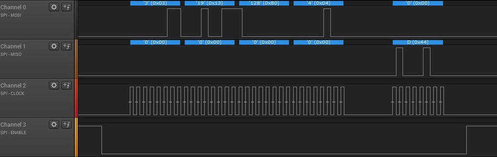

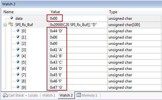

Here is the result of these functions;
As you can see, single byte read has returned
0x00
instead of
'D'
and multibyte array result has
shifted 3 bytes

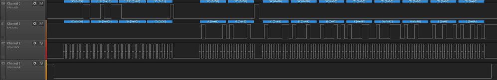

and 1st byte is corrupted. BUT, logic analyzer shows that signal on the SPI bus seems as expected. 0690X00000603B6QAI.jpg 0690X00000603BkQAI.jpg If I removed the
comments

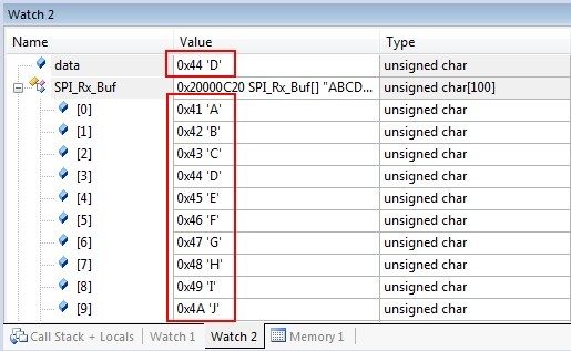

on dummy 3 bytes read everything gets OK !
functionHAL_SPI_Receive(&hspi1, (uint8_t*)SPI_Rx_Buf, 3, 100);
Adding 3 extra read sequence clocking bus for extra 3 bytes but it does not a problem for SPI flash, it just continue to out data by increasing its address. There is no any data except the written capital letters, so remaing 3 extra ouput data is 0xFF as expected. 0690X00000603B7QAI.jpg Now it seems OK but why do I need this weird approach ? Here is the SPI configuration data 0690X00000603BBQAY.jpg

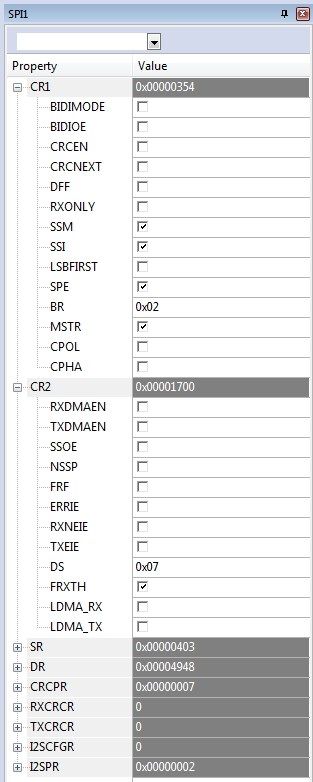

Here is the SPI configuration code;
void MX_SPI1_Init(void)
hspi1.Instance = SPI1;
hspi1.Init.Mode = SPI_MODE_MASTER;
hspi1.Init.Direction = SPI_DIRECTION_2LINES;
hspi1.Init.DataSize = SPI_DATASIZE_8BIT;
hspi1.Init.CLKPolarity = SPI_POLARITY_LOW;
hspi1.Init.CLKPhase = SPI_PHASE_1EDGE;
hspi1.Init.NSS = SPI_NSS_SOFT;
hspi1.Init.BaudRatePrescaler = SPI_BAUDRATEPRESCALER_8;
hspi1.Init.FirstBit = SPI_FIRSTBIT_MSB;
hspi1.Init.TIMode = SPI_TIMODE_DISABLE;
hspi1.Init.CRCCalculation = SPI_CRCCALCULATION_DISABLE;
hspi1.Init.CRCPolynomial = 7;
hspi1.Init.CRCLength = SPI_CRC_LENGTH_DATASIZE;
hspi1.Init.NSSPMode = SPI_NSS_PULSE_DISABLE;
if (HAL_SPI_Init(&hspi1) != HAL_OK)
Error_Handler();
void HAL_SPI_MspInit(SPI_HandleTypeDef* spiHandle)
GPIO_InitTypeDef GPIO_InitStruct;
if(spiHandle->Instance==SPI1)
__HAL_RCC_SPI1_CLK_ENABLE();
GPIO_InitStruct.Pin = GPIO_PIN_5|GPIO_PIN_6|GPIO_PIN_7;
GPIO_InitStruct.Speed = GPIO_SPEED_FREQ_HIGH;
GPIO_InitStruct.Alternate = GPIO_AF0_SPI1;
HAL_GPIO_Init(GPIOA, &GPIO_InitStruct);

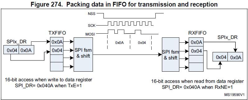

What is the problem ?
Is there a problem in CubeMx function that handling SPI data packaging described below ? Or any point that I am missing ? 0690X000006038IQAQ.jpg Best Regards
