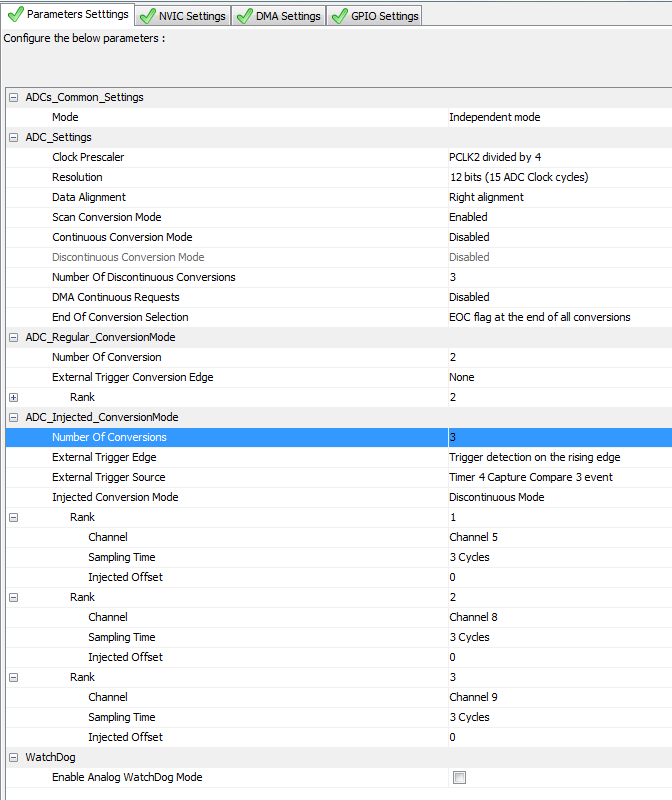

Bug: ADC injected channels code not correctly generated
patrickbrataas9
Posted on November 20, 2014 at 17:09
EDIT:
This was fixed in 4.4.0
I am using the ADC3 injected channel to convert 3 channels on each external interrupt, but it is missing this line in the generated code:
sConfigInjected.InjectedNbrOfConversion = 3;
before running HAL_ADCEx_InjectedConfigChannel().
Below I have added a screenshot of my ADC3 configuration in STM32CubeMx.
I am using STM32CubeMX 4.3.1, which I know is not the newest, so if this have been fixed, where can I find that information?
