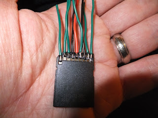

elec_st
Posted on January 24, 2014 at 17:41
i'm beginner with sd card and i use this your project at this link
https://my.st.com/public/STe2ecommunities/mcu/Lists/cortex_mx_stm32/DispForm.aspx?ID=25551&RootFolder=https%3a//my.st.com/public/STe2ecommunities/mcu/Lists/cortex_mx_stm32/SDIO%20and%20SD%20fat%20access%20example
-i use stm32f4 discovery. and i clocked cpu at 42MHZ AND 24MHZ for SDIO .
-i just want READING 2MB/SEC AT 42 MHZ . AND READING about 8MB AT 168MHZ. this is my dream
- i use your project and read 150KB FILE IN ONE SECOND with 16KB BUFFER. with 42MHZ CPU AND 24MHZ SDIO
- sorry i can't answer all your question because i'm beginner and i don't know if your project using dma or what .
https://my.st.com/public/STe2ecommunities/mcu/Lists/cortex_mx_stm32/DispForm.aspx?ID=23354&RootFolder=https%3a//my.st.com/public/STe2ecommunities/mcu/Lists/cortex_mx_stm32/ST32f4discovery%2bsdcard%2bfatfs%20problem
i use 2gb micro sd and it's reading speed is 5MB/SECOND tested from my computer.
my cabel is 10CM with sd adapter like this with 47k pullup resistor.
http://3.bp.blogspot.com/-YRk9TlY-nd0/USNnZXgEJeI/AAAAAAAADsI/e8PyI58nWjA/s320/DSCF14JPG
thank you very much
Posted on January 24, 2014 at 19:19
Ok, I don't think running the CPU at 42 MHz and the SDIOCLK at 48 MHz (24 MHz @ card) is desirable. It causes a clock precedence inversion. The documents suggest it can tolerate an APB2 as low as 9 MHz, but doesn't discuss the AHB/CPU clocks. Not saying this is the issue, but it's where I'd start.
You perhaps want to either clock the CPU >= 48 MHz, or get SDIOCLK (PLL_Q tap) <= 42 MHz
You have the wires soldered to a Full size SD Card? or was there something else at the blog spot you wanted to point at? You mentioned MicroSD, and all my analysis/diagrams are for MicroSD.
Observations:
10 CM (100mm) is a LONG cable
the 47K pull-up need to be at, or proximate to the card interface.
I'd want to see equal lengths, closer to 30-40 mm
