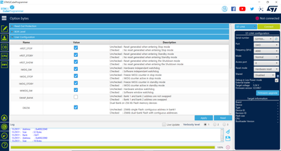

I'm trying to program STM32WBR55VGY microcontroller in my custom board.
Recently, I succeed to debug my microcontroller but after one time, I can see this message on the STM32cubeIDE during debugging and the microcontroller does not work properly.
"Break at address "0x1fff5e8c" with no debug information available, or outside of program code. error."
How can I solve this problem?

You should be able to program and debug via the SWD
The Boot Loader functions independently of the SWD interface, it is code running from ROM.
Your error "break at" is a ROM address, its running ST's code in ROM, not your code in FLASH.
Docs say you can use option bytes in lieu of pin, but needs configuring. For commercial product you likely want access to BOOT0 PIN, along with SWDIO, SWCLK, SWO, NRST, to facilitate production testing and programming
Docs say BOOT1 is via an option switch, ie OPTION BYTES programmed into the device.

The problem isn't with the chip or related to the soldering.
Check option bytes settings in STM32 Cube Programmer
2022-10-11 2:54 AM
Could you recommand any document regarding option bytes?
2022-10-11 8:41 AM
I cited the Reference Manual earlier, please start with that.
2024-02-07 12:24 AM
In the option Bytes Settings in STM32 Cube Programmer what should i check , it means which check box should i check ,I'm also facing same issue.
