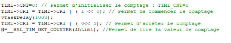

Bonjour, je veux créer une fonction pour calcule les nombres d'impulsion de signal avec une périodisation de 40 ms j'ai configure le timer en mode ETR et reset le Counter puis en lance le Counter mais on ne peut pas de vérifie si le Counter est incrément

I would avoid the TIM1->SR RMW forms, the register is designed to automatically mask the writes such that there aren't race conditions, where you clear flags indiscriminately.
TIM1->SR &= 0xFE; // BAD FORM
TIM1->SR = 0xFE; // HOW HARDWARE WAS DESIGNED

In TIM2 interrupt, you don't need to anything else, just read out TIM1->CNT and subtract it from previously read out value to find out the difference, and store the new value. Don't stop TIM1, don't clear TIM1->CNT. TIM1 is 16-bit counter, so you have to take this into account when TIM1->CNT overflows.
But first make sure TIM1 works - simply set it up as you intended, enable, and then without doing anything with it just observe in register view of debugger, if TIM1->CNT counts accordingly to the input signal.
