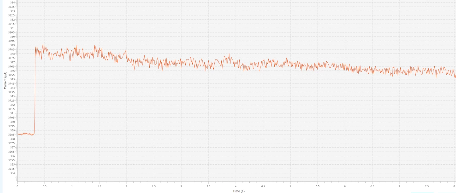

stm cubemonitor power, multiple measurements
  • between 370 uA and 380 uA
  • sometimes more ripple, sometimes less
  • several times jumps in current, see one example image

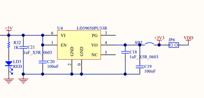

Question 1
Given Run Mode
~375uA Board incl MCU  -  ~210uA MCU   —> ~165uA board
UART2 is configured but not in action
Given Standby Mode
~162uA Board incl MCU  -  ~2uA MCU   —> ~160uA board
 Where is the ~160uA going on the board

A current jump as in the screenshot has happened to me quite often. Is this OK for the v3pwr ?

Schematic should guide you on where to look.
Looks like you are backpowering U4 which is surely drawing some current. Removing SB2 would solve.
Current will spike as the MCU does stuff. No need to be concerned.

ok, will try to remove SB2 cleanly - it's on the top side next to some C and i have no good SMD (un)soldering equipment. will report.
as far as i think the current sawtooth should not be caused by some mcu action, the mcu should standby (code).

i removed sb2 and now get , with the same code that goes to standby, roughly 1.85 uA consumption.
a) that consumption is fine
a1)  it would be great if sb2 was a (mini)jumper
a2) would not have expected that U4 consumes that much current when backpowered, but i'm a software developer
b) the jump in the graph still has no explanation. i saw similar jumps before. still wondering if this is some v3pwr artefact
