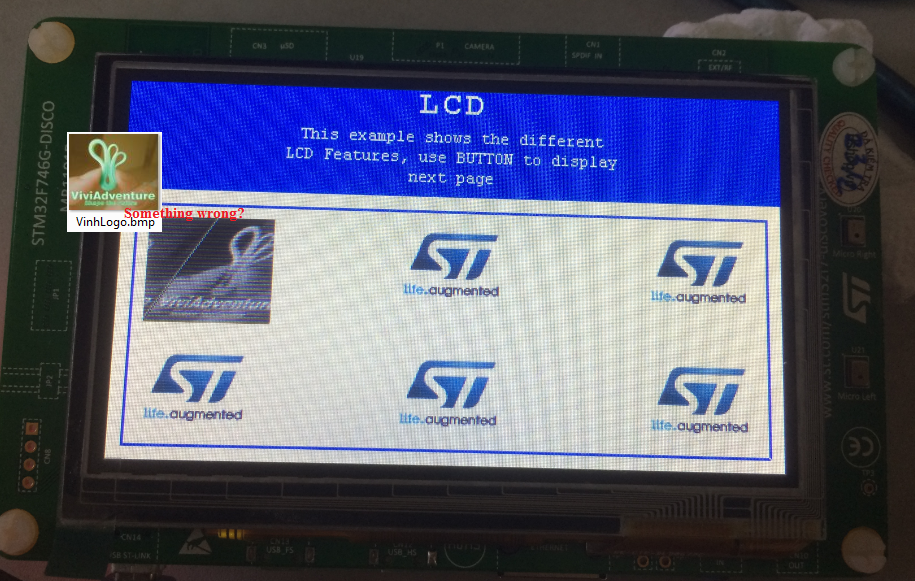

Recently, I created a Win32 application to convert a bitmap (.bmp) file into a header file (.h) in order to display it in mySTM32F746G-DISCO discovery board. Everything works fine but the bitmap (24 bit depth) displays differently (see attached photo) compared to the original bitmap.
Does everyone experience the same? The displayed bitmap seems to be skewed and de-colored. I have done again with a 16-bit-depth bitmap but no further advance.

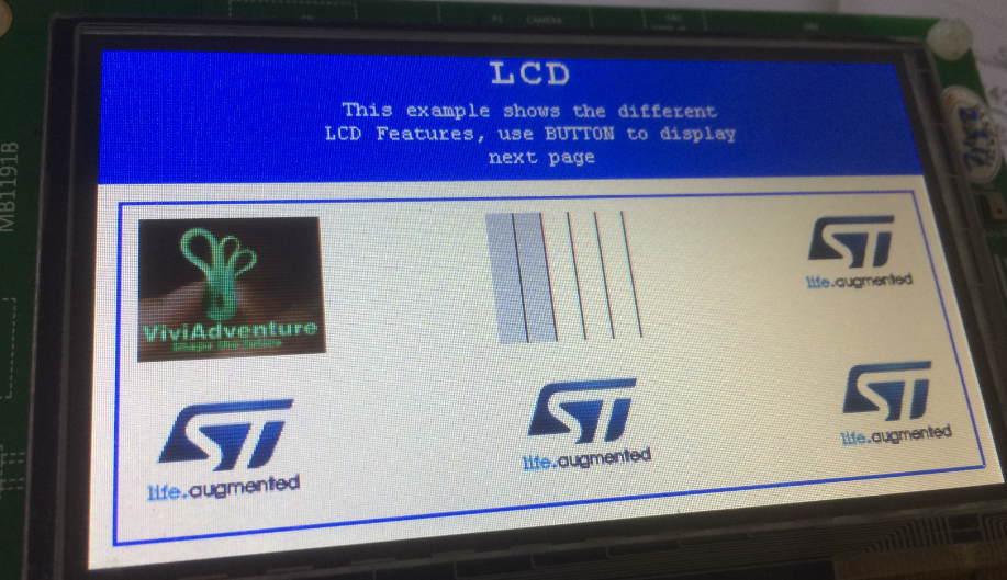

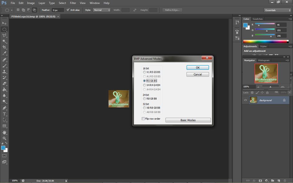

Yeah! Finally I have resolved the problem:
The problem is that there are many formats for a .bmp file. The original bitmap is of 24 bit depth so the LCD driver handled it poor. I changed it to 16 bit, it displayed well (no skew anymore) but with just a few color. I used Photoshop to change it to RGB565 and it is OK.

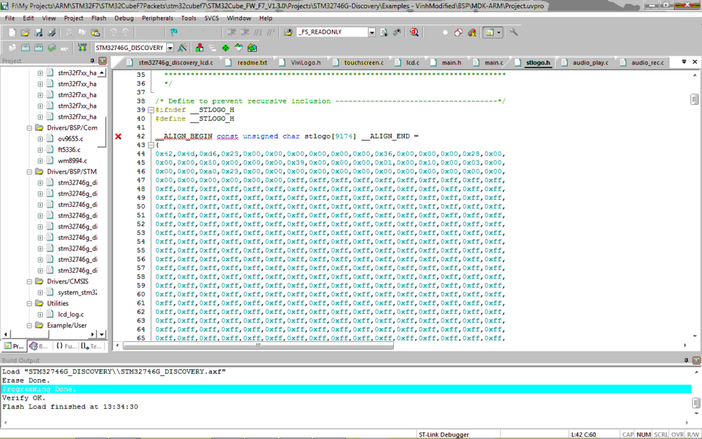

I converted the entire .bmp file where the header contains all information about the index, width, height and bit-depth. I also found that the LCD driver has mechanism to check it. Something likes below:
/**   * @brief  Draws a bitmap picture loaded in the internal Flash in ARGB888 format (32 bits per pixel).   * @param  Xpos: Bmp X position in the LCD   * @param  Ypos: Bmp Y position in the LCD   * @param  pbmp: Pointer to Bmp picture address in the internal Flash   * @retval None   */ void BSP_LCD_DrawBitmap(uint32_t Xpos, uint32_t Ypos, uint8_t *pbmp) {   uint32_t index = 0, width = 0, height = 0, bit_pixel = 0;   uint32_t address;   uint32_t input_color_mode = 0;      /* Get bitmap data address offset */   index = *(__IO uint16_t *) (pbmp + 10);   index |= (*(__IO uint16_t *) (pbmp + 12)) << 16;      /* Read bitmap width */   width = *(uint16_t *) (pbmp + 18);   width |= (*(uint16_t *) (pbmp + 20)) << 16;      /* Read bitmap height */   height = *(uint16_t *) (pbmp + 22);   height |= (*(uint16_t *) (pbmp + 24)) << 16;       /* Read bit/pixel */   bit_pixel = *(uint16_t *) (pbmp + 28);         /* Set the address */   //address = hLtdcHandler.LayerCfg[ActiveLayer].FBStartAdress + (((BSP_LCD_GetXSize()*Ypos) + Xpos)*(4));   address = hLtdcHandler.LayerCfg[ActiveLayer].FBStartAdress + (((BSP_LCD_GetXSize()*Ypos) + Xpos)*(4));      /* Get the layer pixel format */       if ((bit_pixel/8) == 4)   {     input_color_mode = CM_ARGB8888;   }   else if ((bit_pixel/8) == 2)   {     input_color_mode = CM_RGB565;      }   else    {     input_color_mode = CM_RGB888;   }      /* Bypass the bitmap header */   pbmp += (index + (width * (height - 1) * (bit_pixel/8)));        /* Convert picture to ARGB8888 pixel format */   for(index=0; index < height; index++)   {     /* Pixel format conversion */     LL_ConvertLineToARGB8888((uint32_t *)pbmp, (uint32_t *)address, width, input_color_mode);          /* Increment the source and destination buffers */     address+=  (BSP_LCD_GetXSize()*4);     pbmp -= width*(bit_pixel/8);   }  }

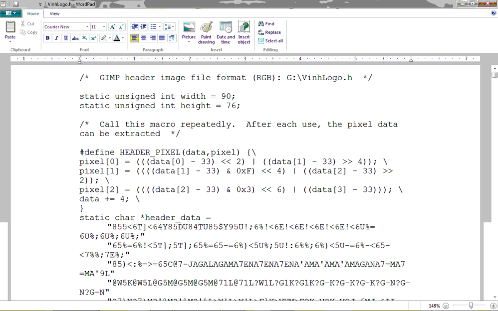

I've already used GIMP but the output files it exports are not as what I expected.  The expected format is as bellow:
But GIMP produces it differently:
Do you have any hint for me?
