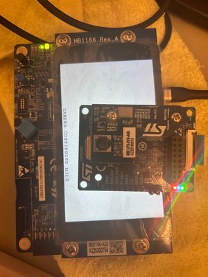

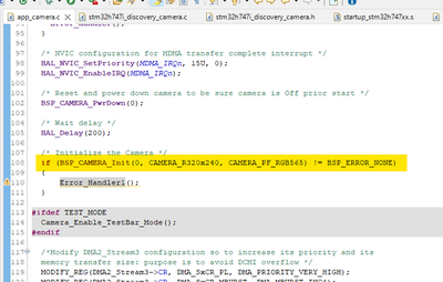

Is my camera module working fine (all 3 LEDs light up)? What is camera continuous mode? Anyone have any information regarding this? I am working with the model zoo image classification project, and facing issue, after troubleshooting by blinking LED of the board. I found that the camera initialization is having error. Can anyone provide any information regarding this? Thanks

Hello @chew ,
I think you face the same issue as reported here.
The BSP_ERROW_UNKNOWN_COMPONENT can happen if the camera is not detected. It might be due either to a wrong connection or a malfunction of the camera board.
I advise you to plug and unplug the camera board while the board is not powered. A short-circuit can happen otherwise.
Could you please try with another B-CAMS-OMV camera board?

After checking the error code is BSP_ERROR_UNKNOWN_COMPONENT based on STM32H747I_discovery_errno.h

ok thanks I will order another module
chew
The problem is camera module malfunction after I changed the camera module the problem solved.

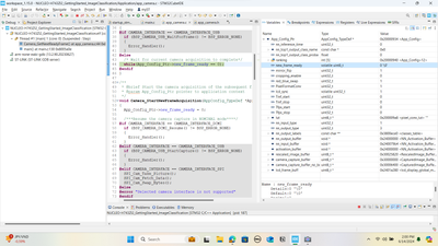

Hello @KDJEM.1 , I have a problem when trying image classification with STM32H743ZI2+ B Cam Omv,
My generated code from ST_Model _Zoo build and flash with Camera DCMI Mode + USB Display oke, but afer i flash, My display stop here , seem like it can;'t get new frame and stay at function while becausce new frame ==0,
I want to ask how to capture image and make it run like example
Best Regards!
