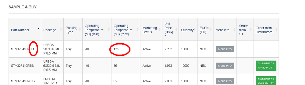

Poorly categorized in Mouser, no F4 explicitly found at 125C, found looking at the auto-complete suggestions in the part search box (ie looked for 3 suffix as typing STM32F4..)
http://www.st.com/en/microcontrollers/stm32f401cb.html
ST's Data Sheet is out of date, doesn't describe 125C part

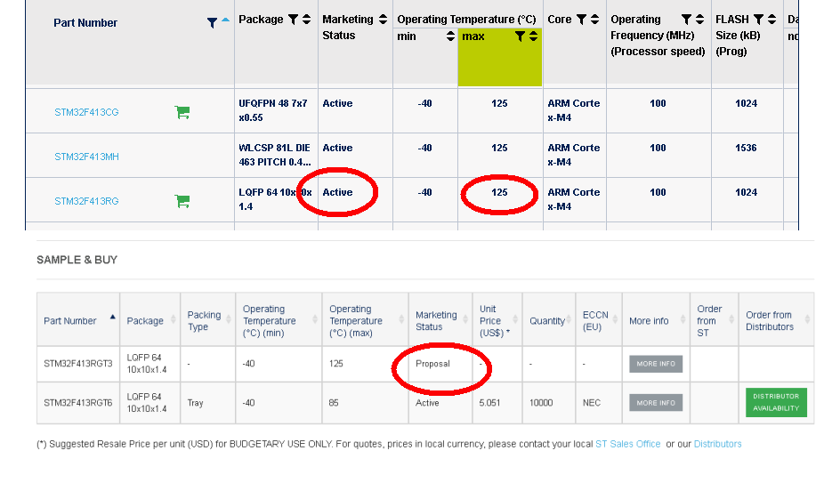

I have used the same filter on that table. Sadly, it does not indicate real availability at the ''garage-scale'' distributors.
And not only that:
I understand why, it's just that it's again misleading and does not help in searching.
I don't try the ''selector'', as I won't install Java (wonder why would that need to be so).

Hi Jan,
The selector is behaving in a way that it marks a line as active as soon as at least one given device belonging to this line is active.
This is the case for STM32F413RG.
-Amel
‎2017-05-22 10:47 AM
Hi Amel,
Thanks. As I wrote above, I understand why is it so; I just said it may be confusing.
Jan
