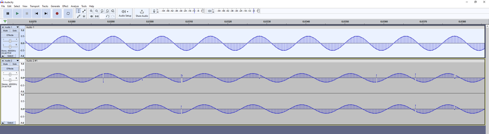

Hi all,
I am using the SAI peripheral on the STM32H753 and I have it set-up as follows:
SAI2A - Master TX, asynchronous
SAI2B - Slave RX, synchronous with sub-block A
SAI3A - Slave TX, synchronous with SAI2
SAI3B - Slave RX, synchronous with SAI2
(SAI2 SYNCOUT has been set to SAI_SYNCEXT_OUTBLOCKA_ENABLE)
Audio from SAI2A is clean.
Audio from all other SAI sub-blocks has glitches as shown below.
Audio 1 - Source signal
Audio 2 - Output from SAI2B
I am using the simplified initialization mode using HAL_SAI_InitProtocol() with number of slots set to 2 and data size at 32 bits.
I am starting all the slave sub-blocks before starting the master. I have also tried adding a delay between starting the slaves and the master, but it didn't make a difference to the behaviour.
I am using circular DMA to transfer audio to/from the SAI sub-blocks and I have disabled D-Cache for the SRAM section which contains the DMA buffers.
SAI FIFO thresholds are currently set to SAI_FIFOTHRESHOLD_EMPTY, but I have also tried other FIFO levels (half/full) and it has not made a difference to the behaviour.
I appreciate any thoughts on the setup and possible explanations for the behaviour.
Thank you

Are all DMA buffers in the correct RAM areas? Check buffer addresses and compare to memory area / ref manual.
In case of doubt use linker file / attribute to force buffers where they can be accessed by the DMA.
DMA priorities set high?
What are you doing in the half / complete callbacks? Any lengthy buffer copying?

I switched over to using double buffer mode, but I was still seeing glitches happening on the boundary of the DMA buffer.
For example, if my DMA buffer size is 96 samples, I would see glitches at multiples of 96 samples.
However, I seem to have found a magic DMA buffer size (64 samples) which does not cause any glitching.
(Each SAI sub-block uses 2 buffers of 64 samples each)
I can't come up with an explanation for this yet, keen to hear any thoughts on this.
I have aligned my DMA buffers to start at 32-byte aligned addresses and all DMA buffers are in SRAM2, with the entire SRAM2 set to be a non-cacheable.
