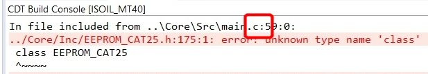

diego ambroggi
Hello Andrew
I imported Arduino EEPROM_CAT25 files (.cpp .h) and I tried to instance EEPROM_CAT25 object.
Error is shown in jpeg file attached
Thanks in advance
Diego
diego ambroggi
This is Arduino code for EEPROM
As I said, the .c extension on main.c tells the compiler to compile is as 'C' - not C++
Clearly, the 'class' keyword is not valid in 'C' !
If you're going to have part of your project in 'C', and part in C++, I think it's generally recommended to make your 'main' a C++ file.
This is general - not specific to STM32 or GCC.
